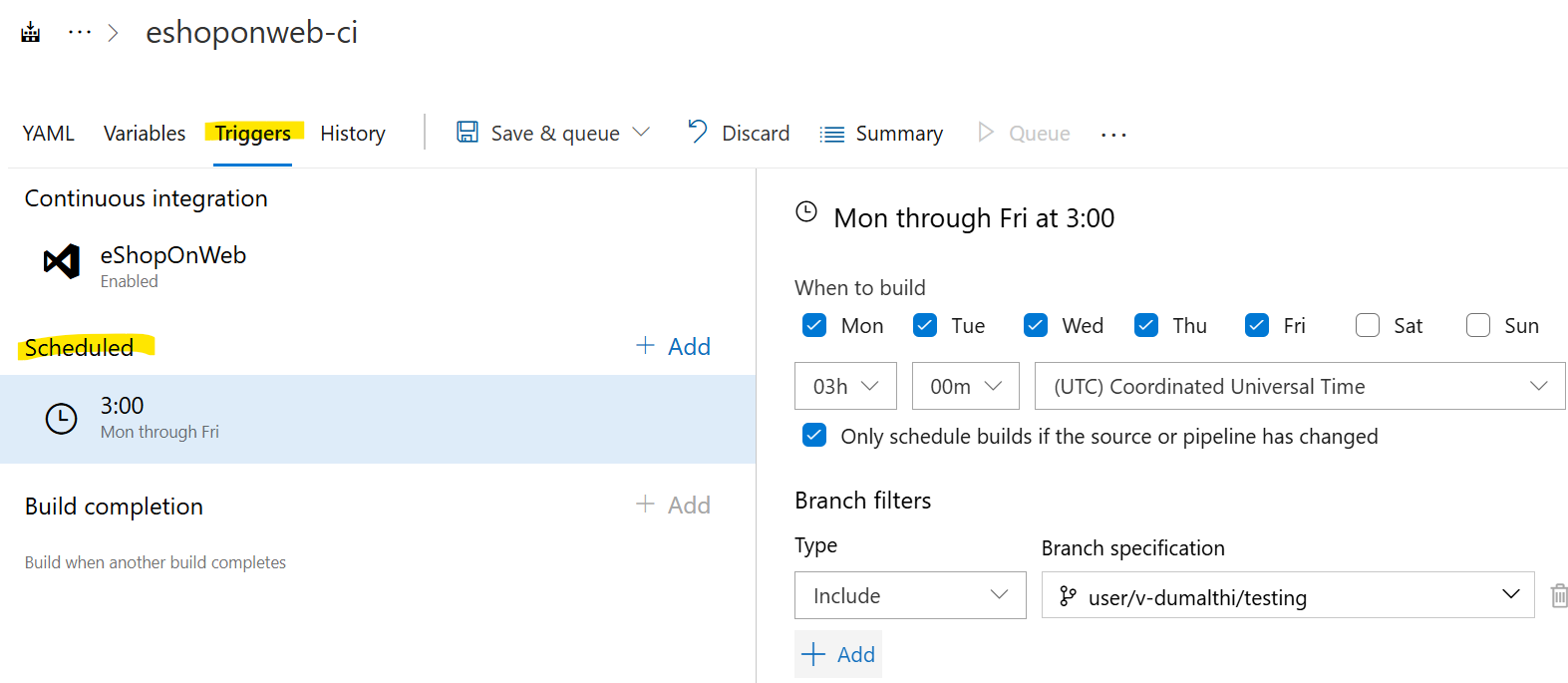

    If you see something like this, it's causing the pipeline to trigger at 4 AM daily. If you don't want scheduled triggers, simply remove this section or adjust it accordingly.
    schedules:
    - cron: "3 4 * * *"
    displayName: "Run at 4:03 AM daily"
    branches:
    include:
    - main
    If your pipeline is configured to trigger on pull requests, consider disabling this option if it is not required. Remove the pr trigger section from the yaml file.

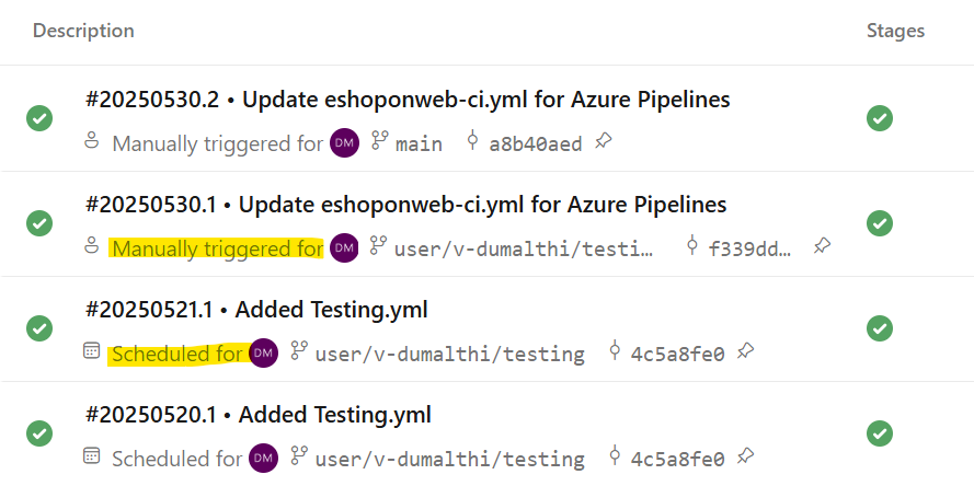

    Navigate to Azure Pipelines and look at trigger type for each run. If its Manual, then someone manually triggered it. If it says Scheduled, a scheduled trigger is causing it. If it says CI Trigger, a code commits, or merge triggered it.

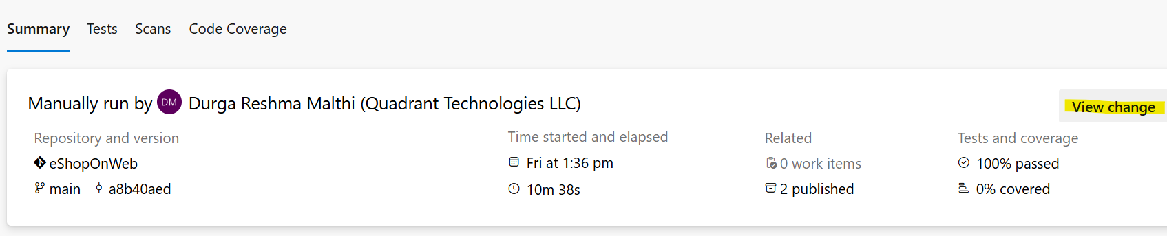

    User's imageNavigate to Azure Pipeline and click on view change to see the latest commits.

    If you go to the pipeline run history it will tell you what triggered it. If it says Manual then somebody triggered it manually. If it says something about Batched CI, PR or similar then it was triggered by a CI trigger.
    If you click on the "reason" then it will take you to the run details. If it is related to a CI call then the Changes link takes you to the PR (or CI trigger) that triggered it. If it was manual then it tells you who triggered it.

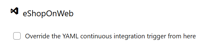

    2. Go to Azure DevOps -> Pipelines -> Your Pipeline. Click on Edit -> Triggers -> Ensure that Override the YAML trigger from here is disabled. User's image

    5. Explicitly Disable Scheduled Triggers in YAML, this ensures that no scheduled triggers exist.
         schedules: []
         trigger: none
