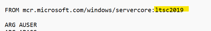

    3. Ensure your host machine or build agent is running Windows Server 2022 or compatible. As per the text file you are using 2019 User's image Replace it with FROM mcr.microsoft.com/windows/servercore:ltsc2022

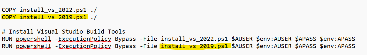

    4. Based on the text file you shared, you’re still copying and executing the install_vs_2019.ps1 script, even though you mentioned removing it. User's image

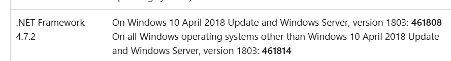

    Based on the error, it looks like the .NET Framework 4.5.2 reference assemblies are missing, which could be causing the validation failure.
    The output 461814 indicates that .NET Framework 4.7.2 is installed, not 4.5.2.
    The command Test-Path "C:\Program Files(x86)\Reference Assemblies\Microsoft\Framework.NETFramework\v4.5.2" returning False indicates that the reference assemblies for .NET Framework 4.5.2 are not present in the expected directory.

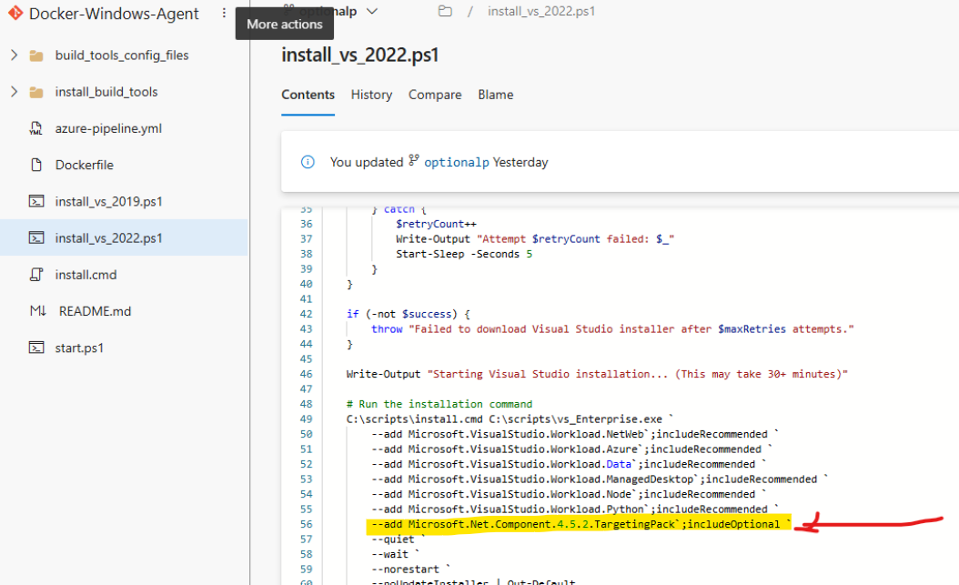

    Firstly, in this docker file
    Update this to --add Microsoft.Net.ComponentGroup.TargetingPacks.4.5.2 `
    Once updated, rebuild the image and verify with
    Test-Path "C:\Program Files (x86)\Reference Assemblies\Microsoft\Framework\.NETFramework\v4.5.2"
    This should return True:
    If this does not work, then you should execute the below command inside the container to install .NET Framework 4.5.2 properly, Add this command at 70th line
