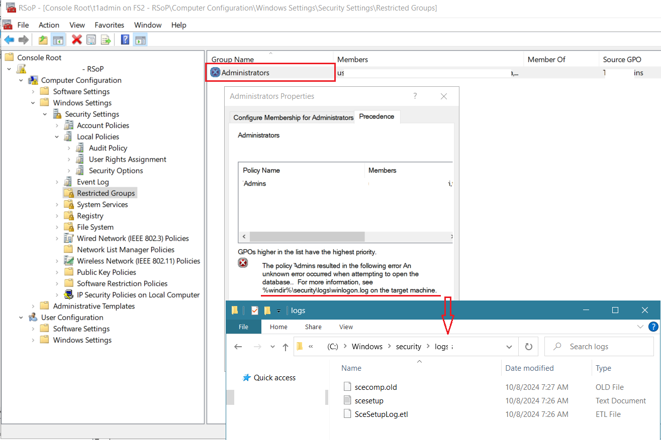

Now when running some tests on a couple of servers I noticed that when I add an account to the local Administrators group and apply the policy (or even restart a server) this "wrong" account does not get removed from the local Administrators group. I checked that policy is applied correctly and then checked RSoP on both servers:
02
The result:

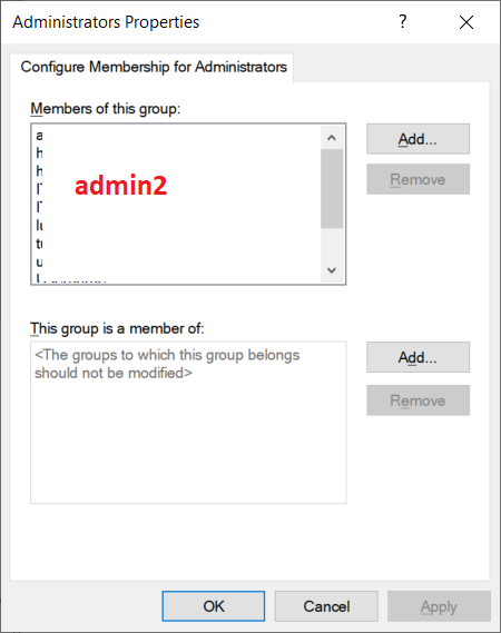

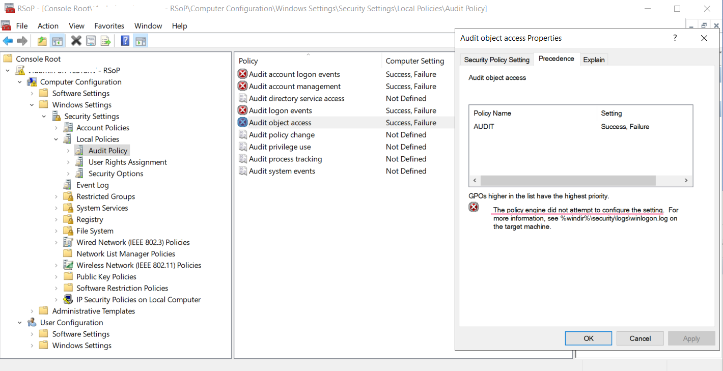

  1. Configure Membership for Administrators tab contains exactly the same accounts as it should ( no accounts were either added or removed)
  2. Administrators (Group name) has the red X
  3. The error (An unknown error occurred when attempting to open the database) on the Precedence tab
  4. Winlogon.log does not exist

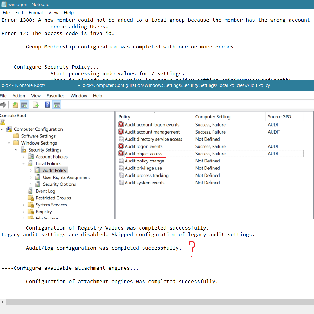

I've already seen the red X in the RSoP data and nevertheless those gpo settings have been applying successfully so
Q1: How could I make sure whether this red X causes the problem in the applying the Admins policy or not?
Q2: I failed to find the solution in resolving the An unknown error occurred when attempting to open the database - what can I do to fix it?

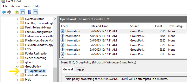

    3. Event Viewer: Specifically, check the Applications and Services Logs > Microsoft > Windows > GroupPolicy > Operational log. This log provides more detailed information about Group Policy processing. Look for events with Activity IDs that correspond to the policy application and any errors within that sequence. User's image

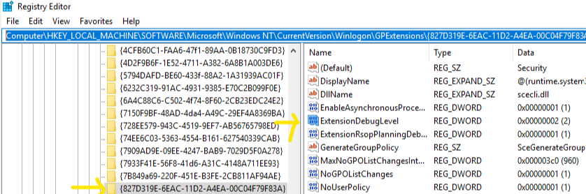

    4. Create/Enable winlogon.log (if not already enabled):
    • The winlogon.log file is crucial for debugging security policy application issues. If it's truly missing, you may need to enable detailed logging for the Group Policy Security client-side extension (SCECLI).
    • Navigate to **HKEY_**LOCAL_MACHINE\SOFTWARE\Microsoft\Windows NT\CurrentVersion\Winlogon\GPExtensions{827D319E-6EAC-11D2-A4EA-00C04F79F83A} (This GUID is for the Security Group Policy Extension).
    • Inside this key, you might find a ExtensionDebugLevel DWORD value. If it exists, set its data to 2 (Hexadecimal). If it doesn't exist, create it as a DWORD (32-bit) value and set its data to 2. User's image

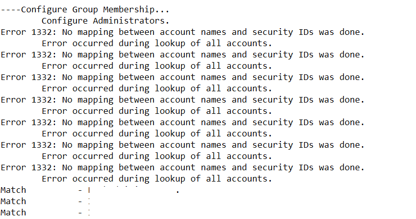

    • After setting this, run gpupdate /force on the affected server and then check C:\Windows\security\logs\winlogon.log. This log should now contain more detailed information about the security policy processing and hopefully, the exact error preventing the Restricted Group from applying. Look for lines containing "Cannot find" or error codes.

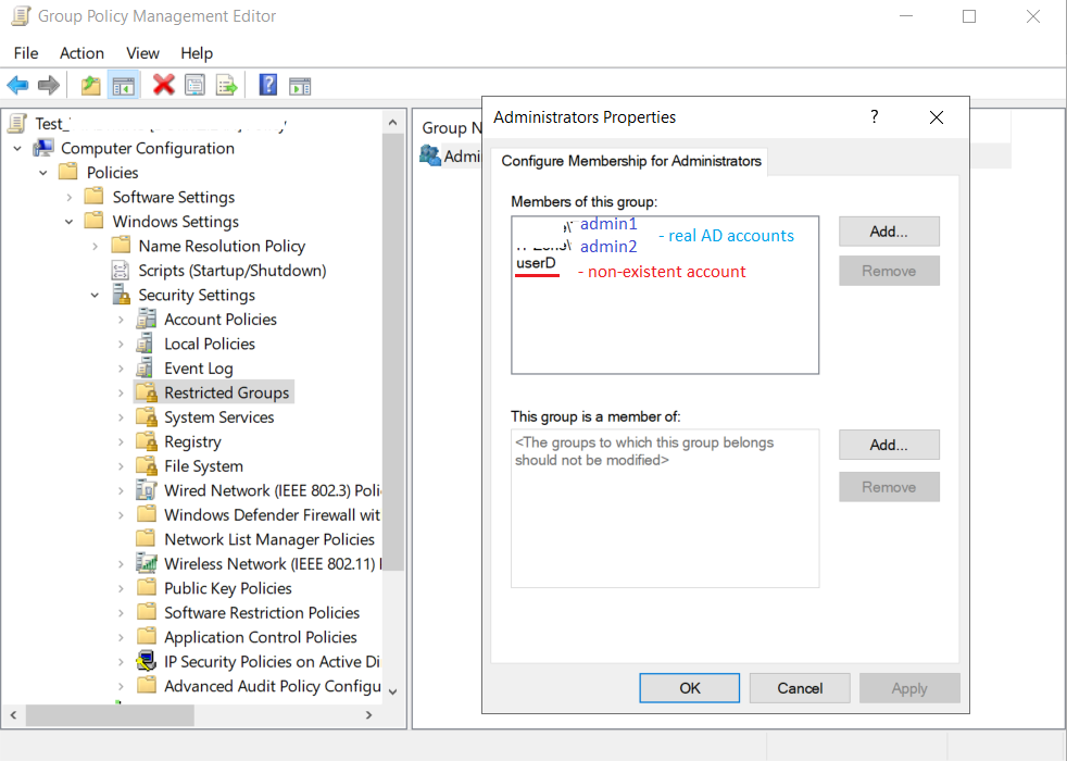

    • Check for Non-Existent Accounts in the GPO:
    1. The most common cause for "An unknown error occurred when attempting to open the database" with Restricted Groups is that the GPO contains an account or group that no longer exists in Active Directory or is misspelled.
    2. Carefully review the "Admins" GPO and ensure all specified accounts/groups are valid and exist in your Active Directory. Even a single invalid entry can cause the entire Restricted Groups processing to fail for that group.
    3. If you enabled winlogon.log (as per Q1), this log often specifically calls out which account it "Cannot find". This is a key piece of information for troubleshooting.
