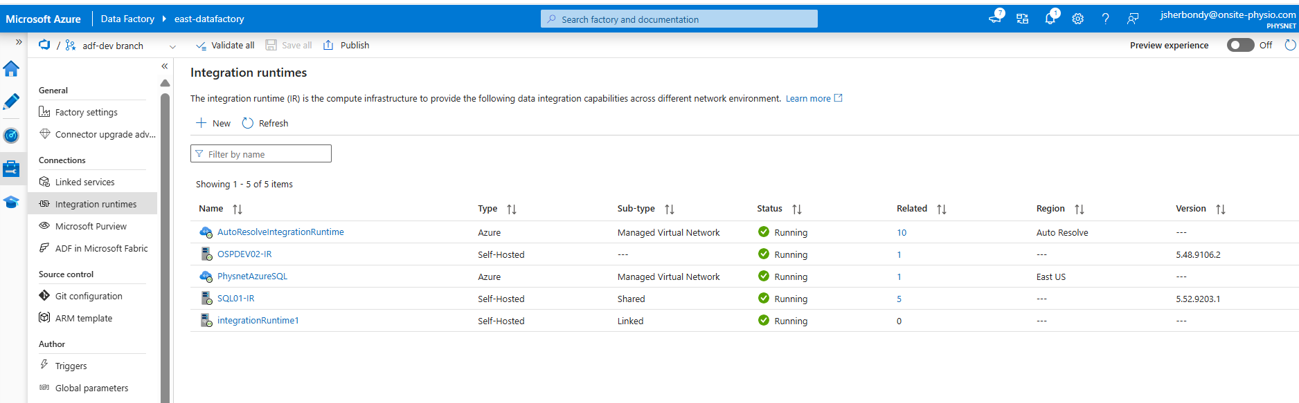

So I have been trying to get CDC working for the past two days but can't seem to get it to connect to my on-premise SQL Server as it seems to have issues using self hosted integration runtime inside the CDC wizard.
I am trying to do incremental loads from my on-premise SQL Server to Azure SQL database so that 5 tables will keep in sync with the production database (OLTP) so that I can build out my OLAP system but can't get the first step.
Could someone please give me some clarification on what is going on here and the best way to keep my tables in sync between these two systems.

    We have reviewed the scenario offline, and I want to confirm that your understanding is correct - currently, the CDC (Preview) wizard in Azure Data Factory does not support connecting to on-premises SQL Server via Self-hosted Integration Runtime (SHIR). This is a known limitation of the preview version, and there is no supported workaround within the CDC wizard at this time.
    1. The SHIR option being grayed out in the CDC wizard UI is expected behavior when targeting on-prem SQL sources.
    2. Even when SHIR is properly installed and registered, the CDC UI does not expose support for on-prem SQL via SHIR in its current preview state.
