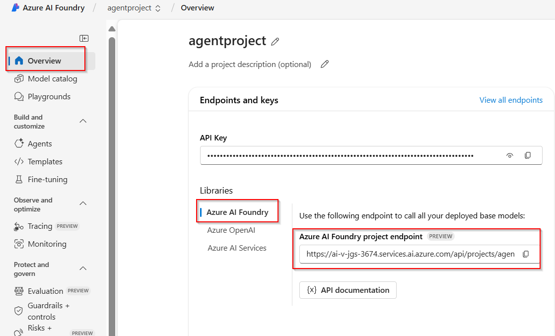

    You can find project endpoint in Project Overview like below.
    enter image description here
    If you don't find the endpoint there or showing connection string then you are having hub-based project instead of having foundry-based project.
    Check this documentation on how to create foundry-based project.
    After creating it you can able to get project endpoint and use it in code like Azar mentioned.

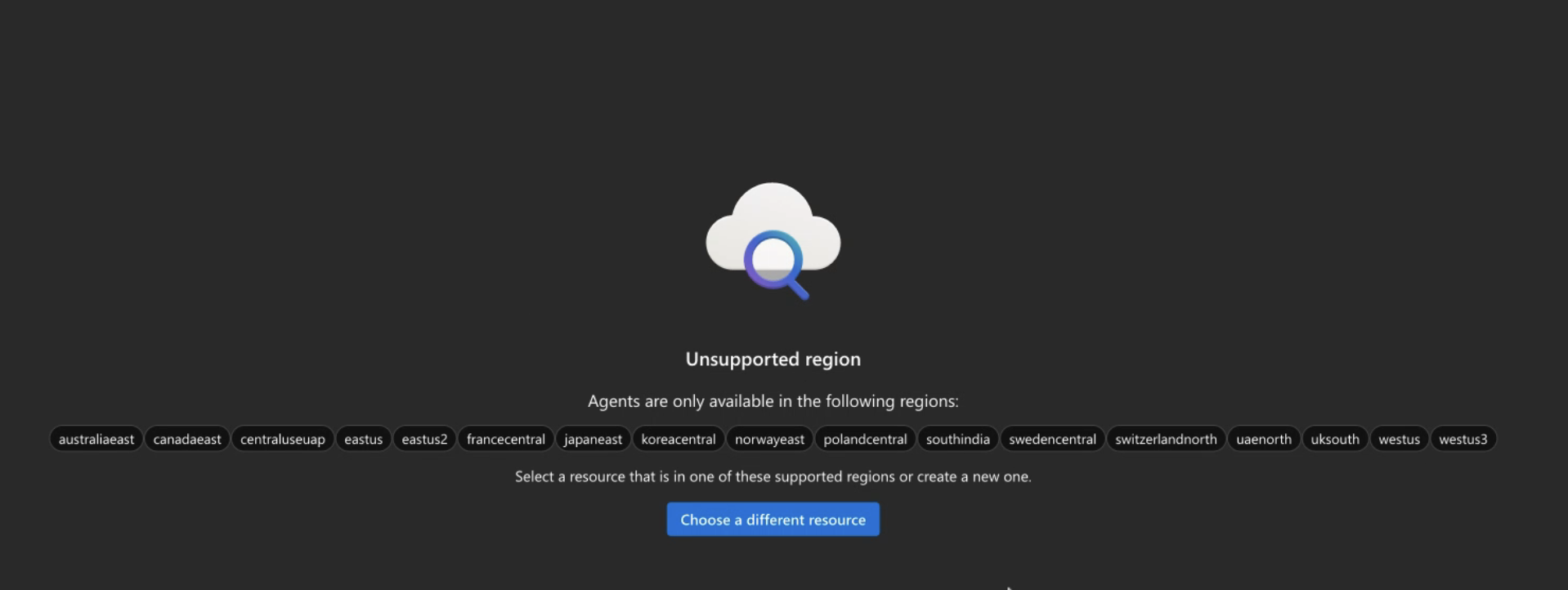

    I created a "standalone" foundry project (outside of a hub) and selected Western Europe but unfortunately got this error under the Agents service tab: Screenshot 2025-06-12 at 16.17.55
    As we are required to only use resources located in Europe (and not Asia or US) I repeated the process but chose NorwayEast. I am now able to see the PROJECT_CONNECTION_STRING and do not get the error as above.
