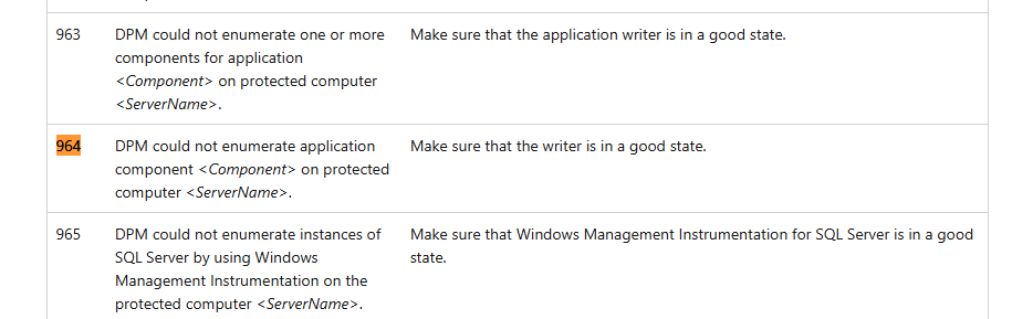

    Error 964 – "DPM could not enumerate application component from the protected server."
    Error 966 – "DPM cannot protect the specified data source because it could not enumerate the application component."

    https://learn.microsoft.com/en-us/troubleshoot/system-center/dpm/vnext-dpm-error-codes#error-codes-900-999
