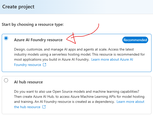

I’ve created an Azure AI Foundry (AI Studio) project at https://ai.azure.com and deployed a model there.

🔧 My Current Setup:
PROJECT_ENDPOINT=https://xxxxxx.services.ai.azure.com/api/projects/yyyyy
MODEL_DEPLOYMENT_NAME=gpt-4.1
AZURE_CLIENT_ID=...
AZURE_TENANT_ID=...
AZURE_CLIENT_SECRET=...
