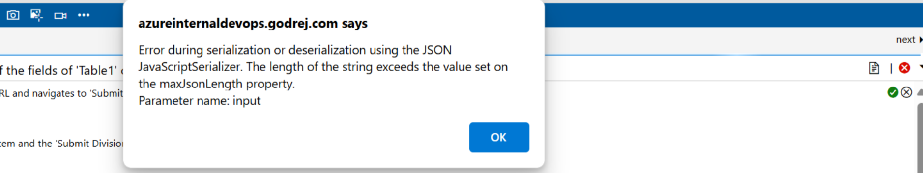

We are facing a persistent error in our on-premises Azure DevOps Server 2022.1 instance while saving or executing test runs in Test Plans.
The exact error is:
Error during serialization or deserialization using the JSON JavaScriptSerializer.
The length of the string exceeds the value set on the maxJsonLength property.
Parameter name: input
This happens even when splitting test cases into minimal steps and ensuring no attachments or rich content are added.

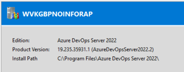

  2. Kapildev Gupta 0 Reputation points
    2025-06-10T04:50:17.6166667+00:00
    Hi Durga Reshma Malthi,
    Thanks for your response, I did upgrade to the latest patch and have rechecked the configuration, but still facing the same issue (ref ss).
    Any help in resolving this is really appreciated

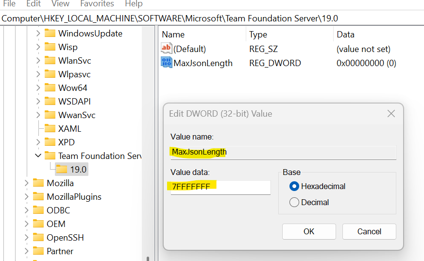

  5. Durga Reshma Malthi 4,430 Reputation points Microsoft External Staff Moderator
    2025-06-10T10:59:21.97+00:00
    Hi Kapildev Gupta
    To update these registry values, go to Registry Editor ->
    1. Navigate to: HKEY_LOCAL_MACHINE\SOFTWARE\Microsoft\TeamFoundationServer\19.0 -> Right-click in the right pane and select New -> DWORD (32-bit) Value -> Name it MaxJsonLength and double click and then set the Value Data to 7FFFFFFF. User's image
    2. Navigate to [HKEY_LOCAL_MACHINE\SYSTEM\CurrentControlSet\Services\W3SVC\Parameters] -> Right-click in the right pane and select New -> DWORD (32-bit) Value -> Name it MaxFieldLength and set the Value Data to 00010000 and also add MaxRequestBytes. with value 01000000
    Hope this helps!
