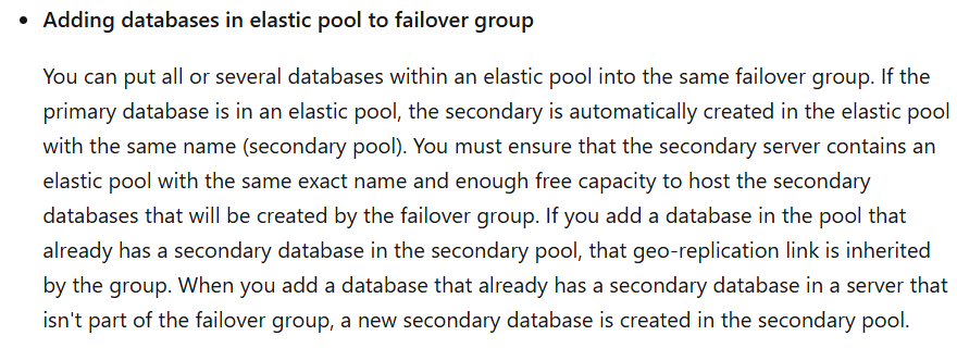

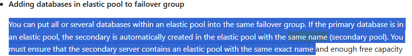

  1. Obinna Ejidike 1,835 Reputation points
    2025-06-09T09:40:29.8333333+00:00
    Hi ElenaMarlowe-3376
    Thanks for using the Q&A platform.
    Regarding your first, the answer is No, SQL servers in a failover group can be in different resource groups. The failover group works at the logical server level, and no Azure-level enforcement requires both servers to be in the same resource group.
    The error you're seeing is not due to resource group mismatch, but related to the elastic pool name and its presence on the secondary server. The secondary must have an elastic pool with the same name, or you’ll get an error when setting up the failover group.
    Kindly find: https://learn.microsoft.com/en-us/azure/azure-sql/database/failover-group-sql-db?view=azuresql#requirements
    The failover will fail if the elastic pool names don’t match. Even if you manually configure a "standby" elastic pool with a different name, the failover mechanism will not redirect the database unless the target pool has the same name.
