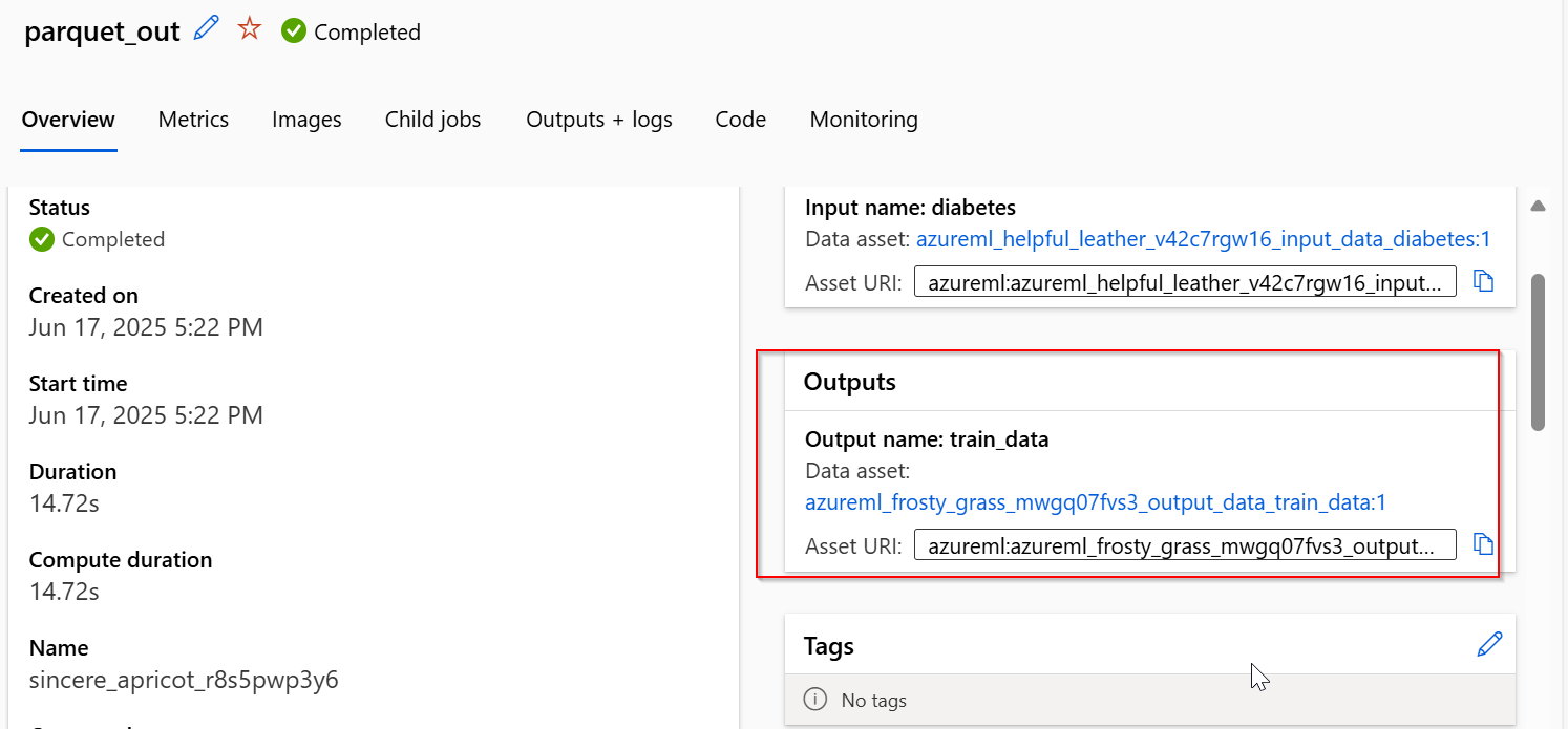

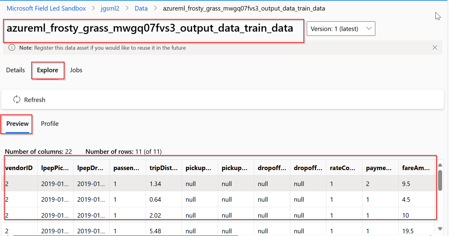

    Output:
    Click on output data asset and explore.
    Try it and let me know if you have any query in comments
