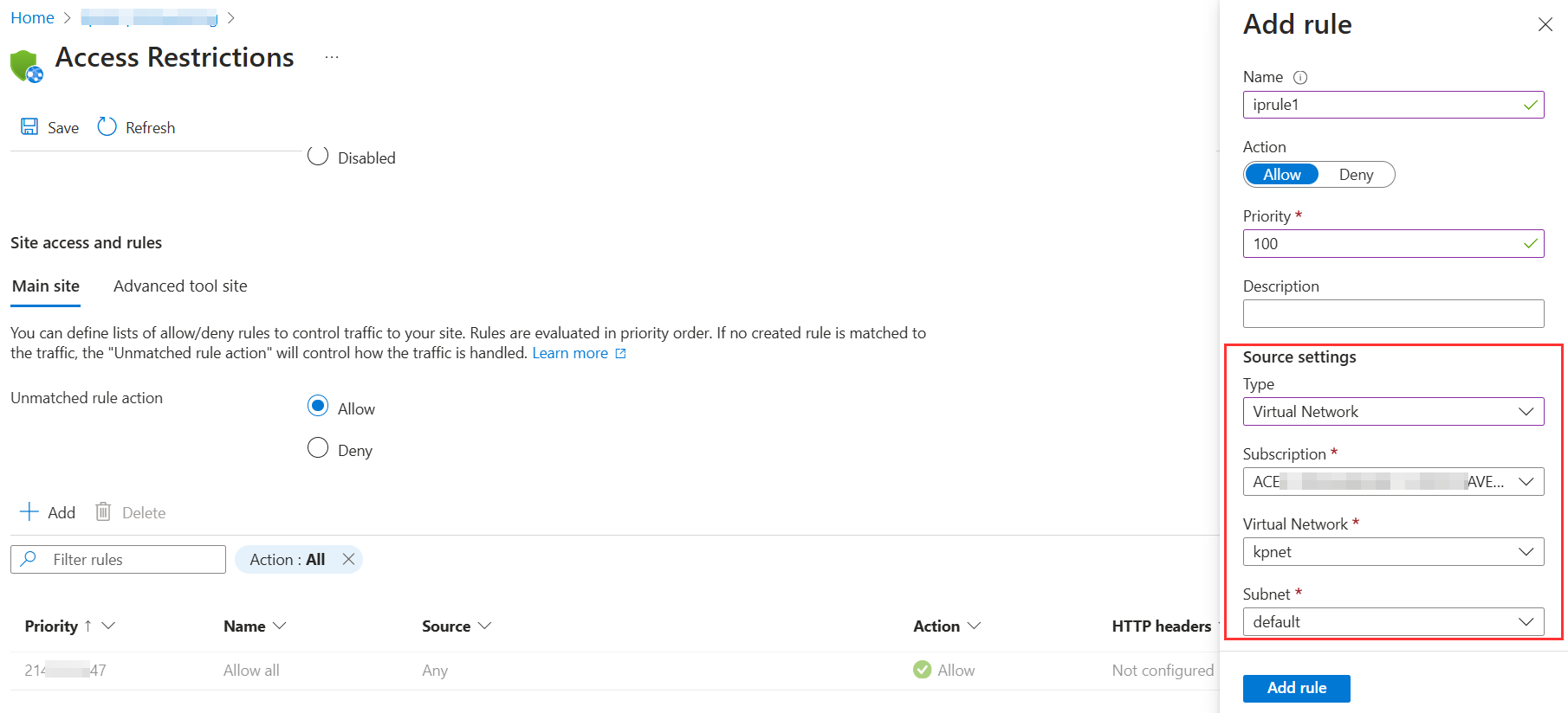

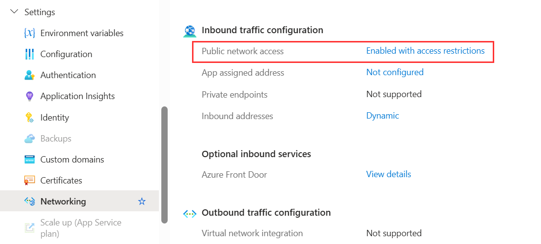

    CORS issue occurs if the access restrictions is enabled in the Azure function App.
    Enable access to all networks or grant access from Ip Address or virtual network.
    enter image description here

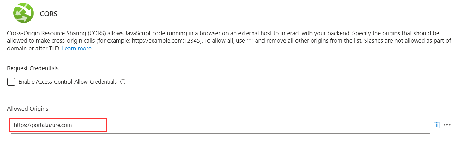

    Configure CORS to allow origins:
    Portal:
    • After enabling network access, able to run the function.
    Please check above suggested steps and let us know with an update.
