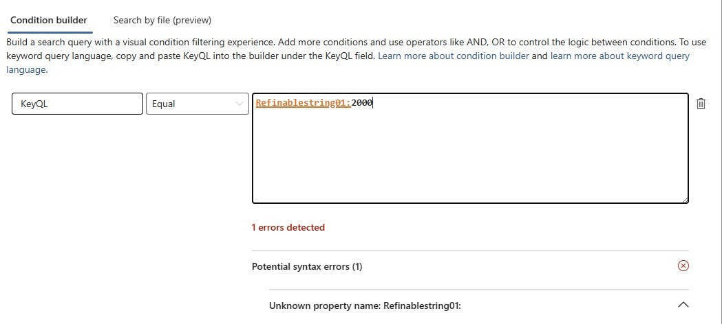

Hello, could help me with the correct KeyQL syntax to use in EDiscovery?
I am wanting to use the e-Discovery to test that retention labels with auto applied policies and event based triggers will find results. Prior to this I was using the old content search in Purview regularly however the new content search does not like the same syntax I was using
This query worked in old Content Search in Purview but can't get it to work in new eDiscovery: Refinablestring01:2000
Refinablestring01 is mapped to crawled property from Term Store. I can search Refinablestring01:2000 in SharePoint and get results.
Error is Unknown property name Refinablestring01:

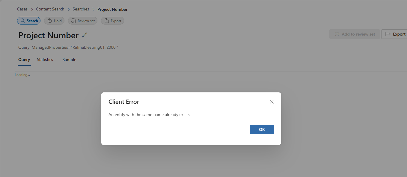

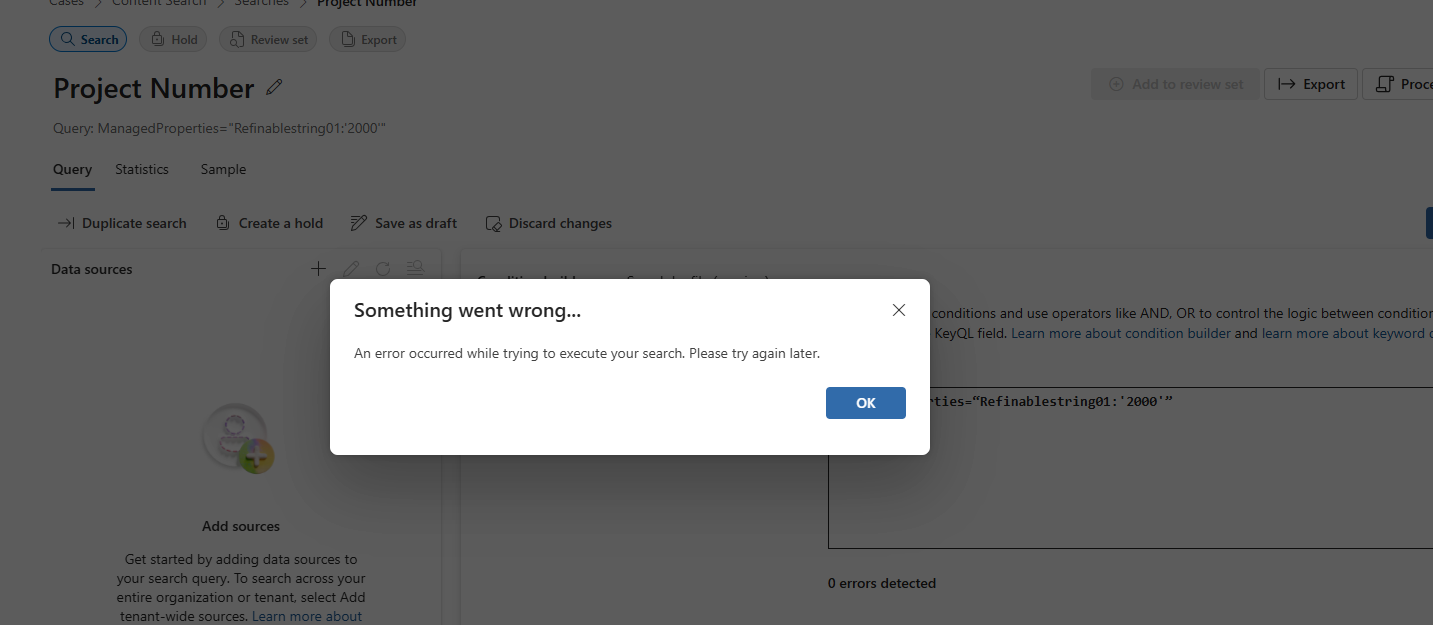

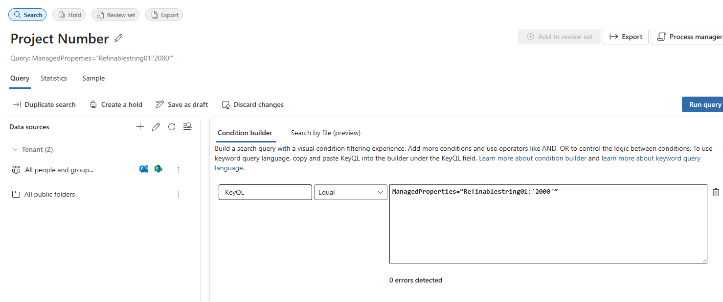

Have also tried ManagedProperties:Refinablestring01:2000
Error is: Propertyrestriction ManagedProperties requires value of type Unknown

    thank you for your reply. I am using this syntax in event driven retention: RefinableString00:"ContractXYZ". the Refinablestring is mapped correctly and I can use it to search in SharePoint and was able to use it to search in the old content discovery search which is not longer avaiable.
    I need to use e-Discovery to test that the queries I need to build for retention events will find results before I create the event.
    When I use this same syntax in e-Discovery I get an error - see above for screen shots. Krupual recommended this syntax which also doesn't work: ManagedProperties="RefinableString00:"ContractXYZ"
    My question is simple: What is the correct syntax to use in e-Discovery to search Refinablestring01?
    The suggestions you and Krupual have already provided return errors.
