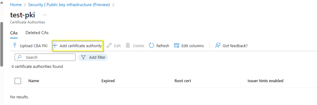

    To fix this, you need to add the PIV certificate’s root and intermediate CAs to your Entra ID tenant’s trusted certificate list.
    Check the PIV issuer’s root and intermediate CA and export the full certificate chain from a working PIV card (root + intermediate certs).
    Upload the PIV certificate chain to Entra ID at Microsoft Entra Admin Center(https://entra.microsoft.com/) -> Certificate Authorities.
    Upload the .cer files for both the root CA and intermediate CA(s). This makes Azure AD recognize and trust the PIV card as a valid identity source.
