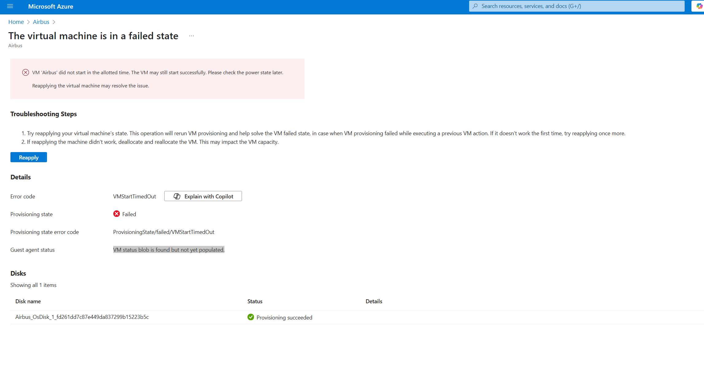

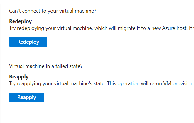

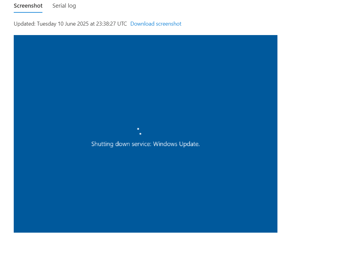

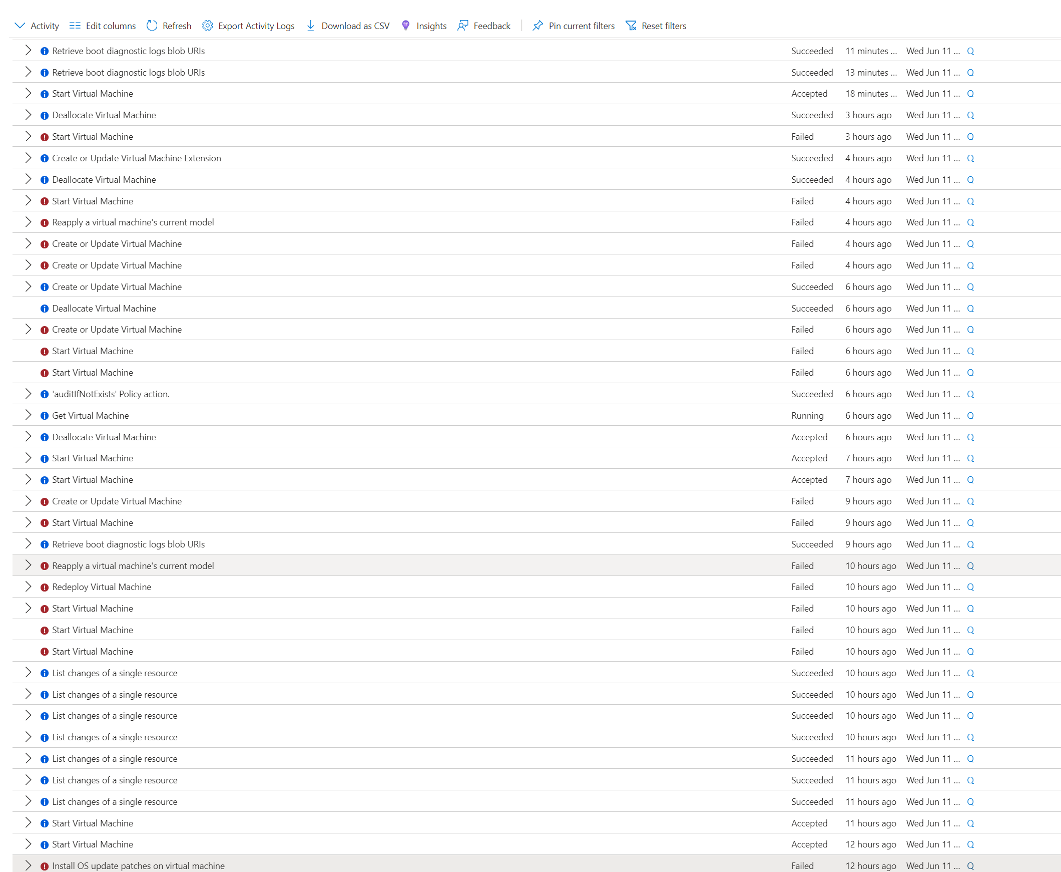

Hi. Since 2025-06-10 23:47:55 according to Azure I have been receiving the following error. I have followed both instructions with no success.My apologies on this being a duplicate post, I had the incorrect tags for the previous one.
