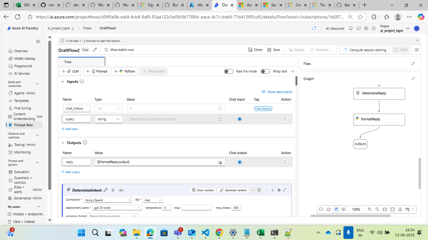

I am working in Azure Machine Learning Studio where I have a compute instance running, and I have successfully created a connection with Azure OpenAI service.

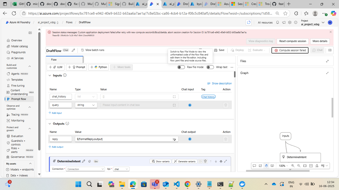

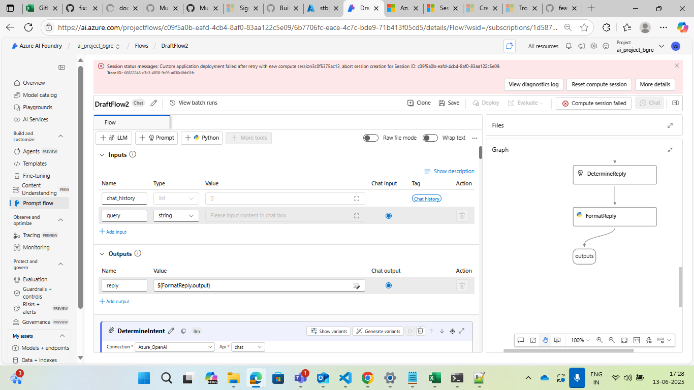

As part of my testing, I was working with Prompt Flow and attempted to create a compute session using the running compute instance. However, I encountered the following error:
Session status messages: Custom application deployment failed after retry with new compute sessionXXXXXXXXXXXX, abort session creation
The diagnostics log said it try to install session with config like below:
2025-06-11 12:01:07 +0 Information Try to Install session with config: {"SessionId":<SESSION ID>,
"VmSize":null,"MaxIdleTimeSeconds":null,"Identity":null,"ComputeName":null,"EnableMultiContainer":false, "ChatGroupExecutionEnvironments":null,"Language":0,"BaseImage":null,"Packages": "promptflow==1.18.0","azure-ai-ml==1.27.1"], "RequirementsFileName":"requirements.txt","RuntimeImage":null}

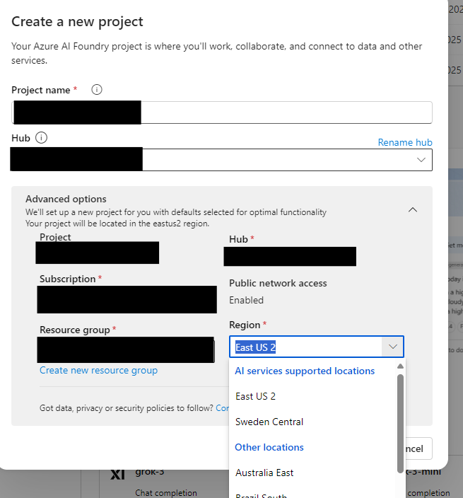

    Hi @Vishal Shinde Please check which region you have created your resources in. I would suggest try creating your resources in EastUS2 or Sweden Central, as these are shown as Supported locations, look at the snip below.
    Thanks
