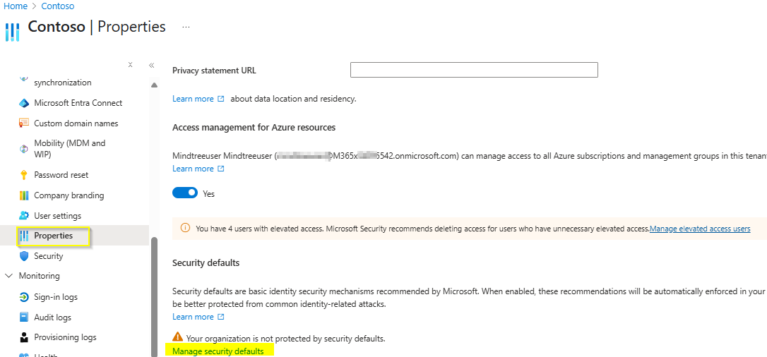

Could you check whether you have a sign-in risk enabled via CA policy on your account. If there is a sign-in risk policy that enforces MFA that might causing you keep you in loop.
AADSTS50076 error usually occurs when there is a matched Conditional Access policies which were not satisfied.
also try disabling the security defaults temporarily if it is enabled and try to access the resource.

Justin Tolchin • 21 Reputation points
2025-06-13T15:26:44.2033333+00:00 Yes, disabling the security defaults allowed access. But this is not acceptable long-term.
How do I restore access and keep security enabled? If it helps, I believe it is related to my being an "external user" to the account. -
