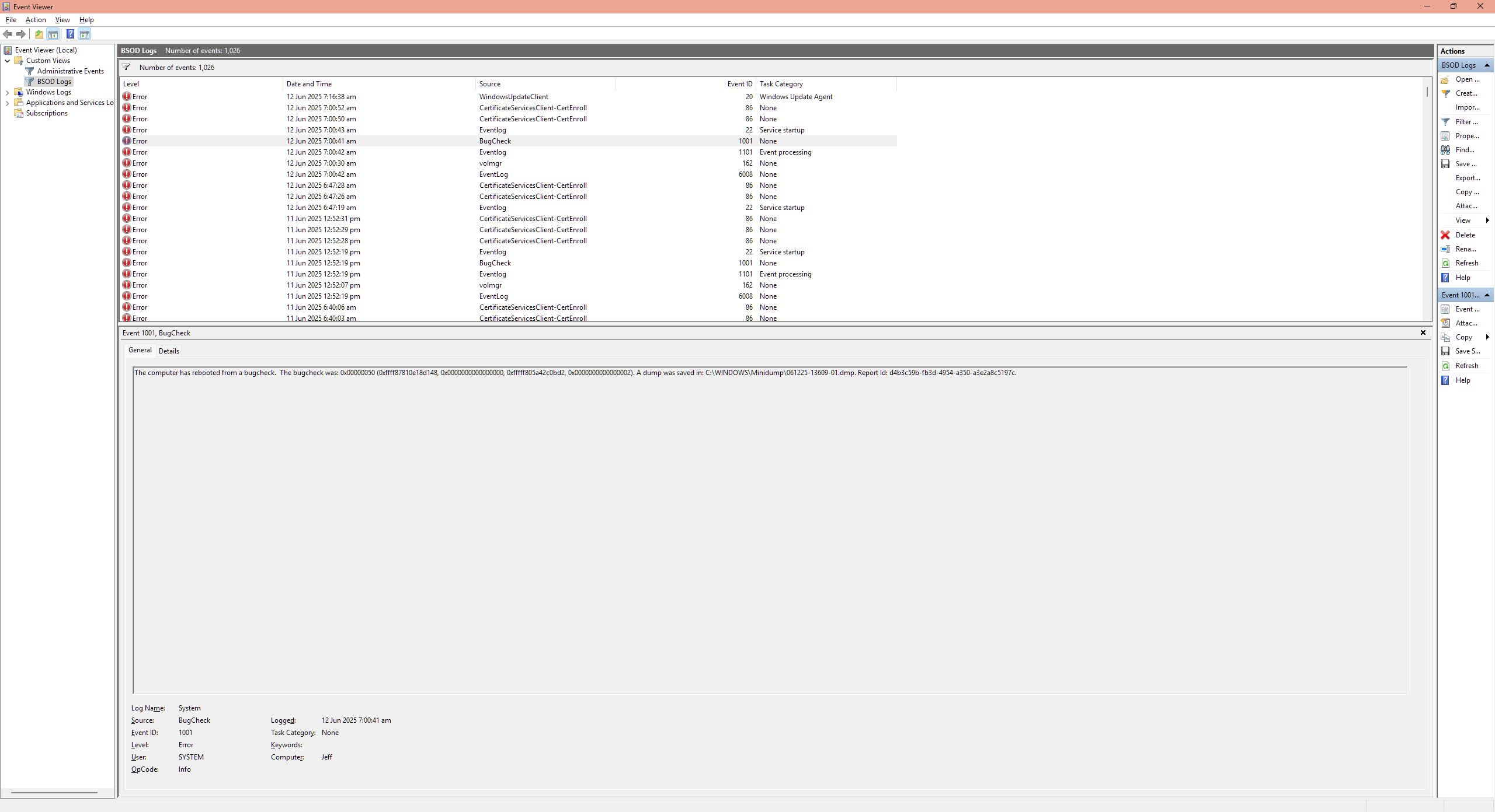

My desktop has been shutting down randomly. Here's a screenshot and the dump files:

    1. Event Viewer: Your screenshot shows multiple "BugCheck" errors with Event ID 1001. The details for the selected event show a bugcheck code of 0x00000050. This is the error code for PAGE_FAULT_IN_NONPAGED_AREA. This tells us that your system is repeatedly crashing due to a critical memory error.User's image

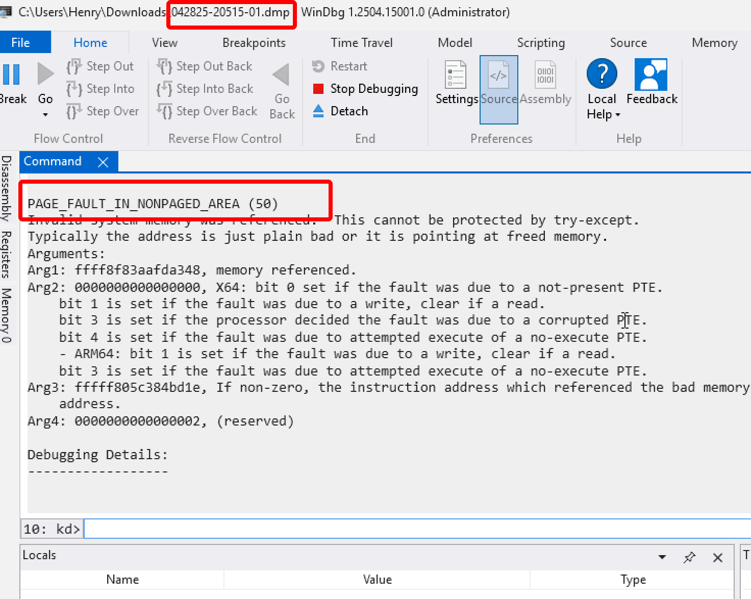

    2. Crash Dump Analysis: The detailed analysis confirms the PAGE_FAULT_IN_NONPAGED_AREA (50) error. Here are the key findings from the dump:

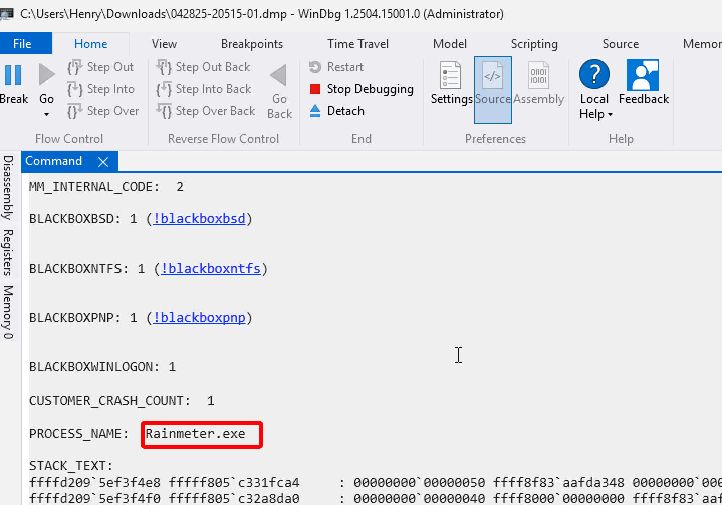

    PROCESS_NAME: Rainmeter.exe: This indicates Rainmeter was the active process when the crash occurred. However, like in many such cases, it is likely the victim of the instability, not the cause.
    • STACK_TEXT: The entire crash sequence happens deep within the Windows Kernel (ntkrnlmp.exe). The functions involved (MiSystemFault, MmAccessFault, KiPageFault) are all core components of the system's memory manager.User's image
    Definitive Diagnosis
    • When a PAGE_FAULT_IN_NONPAGED_AREA (50) error occurs, and the crash dump points to core Windows memory management functions without blaming a specific third-party driver (like a graphics or network driver), it is overwhelmingly likely that the root cause is a hardware issue.
    • The system tried to read data from a memory address that should have been valid but wasn't. This suggests a problem with one of two components:
    • Faulty or Unstable System RAM (Most Likely): This is the number one cause for this type of crash. The RAM could be physically failing or running at an unstable overclocked speed (e.g., via an XMP profile in the BIOS).
    • Failing Storage Drive (SSD/HDD): The Windows Page File, which acts as virtual memory, resides on your storage drive. If the drive is failing, it can become unresponsive or corrupt, leading to page faults when the system tries to access it.
