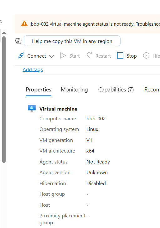

I have setup bigbluebutton on Azure VM Standard_D8as_v5, after installation everything works fine. there are no issues in any functionality. But when I restart the VM, the VM donot respond and the VM went into the error state. This only happens after the succesful install of bigbluebutton 3.0 on ubuntu 22.04 on Azure VM.

    The issue was with UFW, as per bbb documentation we only need to allow port 80 and 443, I have disabled the firewall , and it worked.
