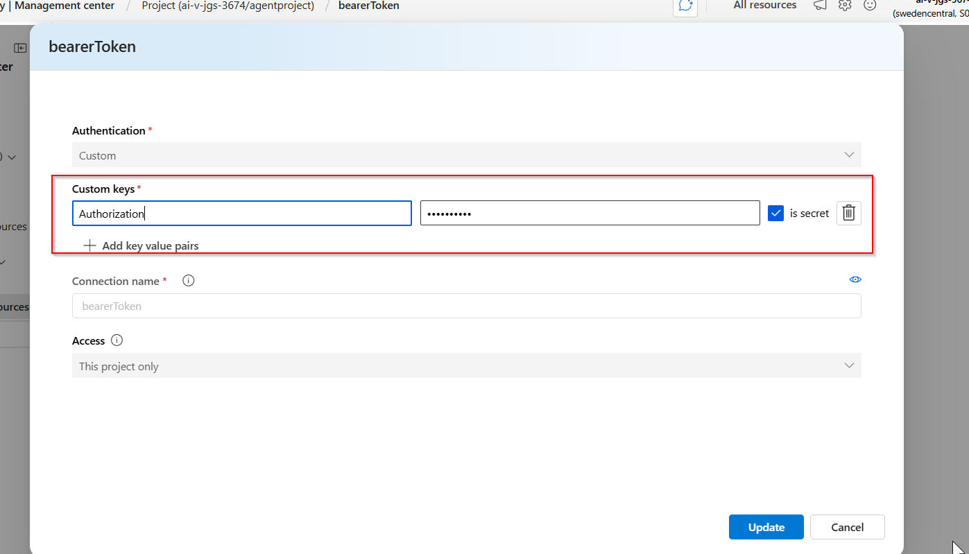

    I believe you have custom key connection like below.
    enter image description here
    key : Authorization value: Bearer your_key

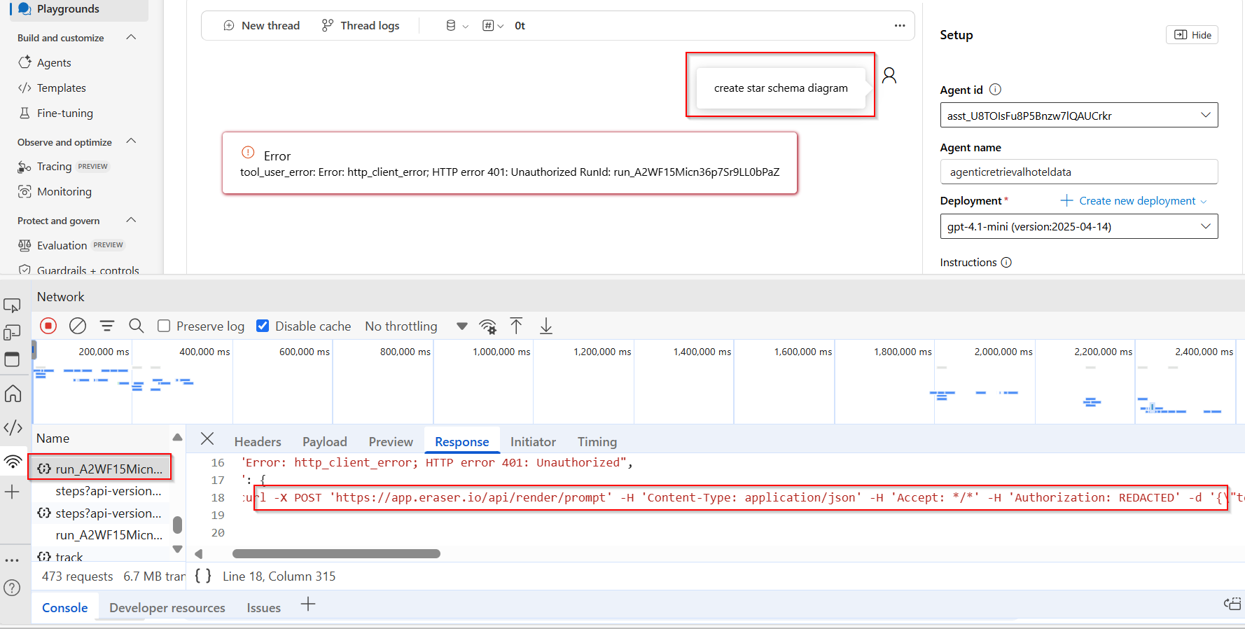

    I have tried agent playground since i am not having exact token getting error but when i check the run details it's making request properly with Authorization header.
    If you see here, it's making curl request with Authorization header.
    Please try above and let me know if you have any query in comments.
