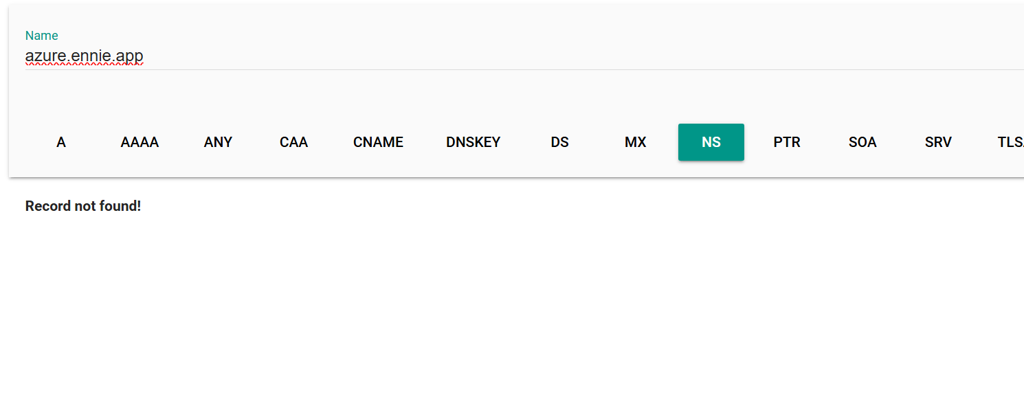

  1. Praveen Bandaru 5,215 Reputation points Microsoft External Staff Moderator
    2025-06-13T22:42:43.4766667+00:00
    Hello dillon.bailey
    I understand that you are experiencing issues with your DNS records not resolving for your domain hosted on Azure DNS, despite adding the records correctly.
    I can see that for your domain, I couldn't find the proper name server, which is why you are facing the issue. Please check the screenshot below.
    Please try to delegate the correct name servers at your domain registrar's DNS zone and verify that the NS records are properly set up with your domain registrar using with https://www.digwebinterface.com/.
    Once delegation is done correctly, you will not encounter resolution issues. It will be resolved properly.

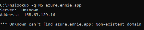

    You need to add NS records at your domain registrar's (GoDaddy.com) DNS to delegate azure.ennie.app subdomain to your Azure DNS zone.
    I checked using nslookup and didn't see the NS records:
    enter image description here

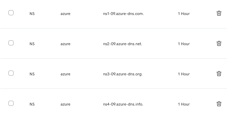

    You would add NS records to ennie.app similar to below:
    azure	3600	IN	NS	ns1-09.azure-dns.com.
    azure	3600	IN	NS	ns2-09.azure-dns.net.
    azure	3600	IN	NS	ns3-09.azure-dns.org.
    azure	3600	IN	NS	ns4-09.azure-dns.info.

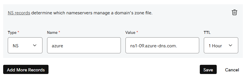

    In GoDaddy portal you would add each of the four NS records one at a time, similar to below:
    Once the above additions take effect the records in your Azure DNS zone will work.
