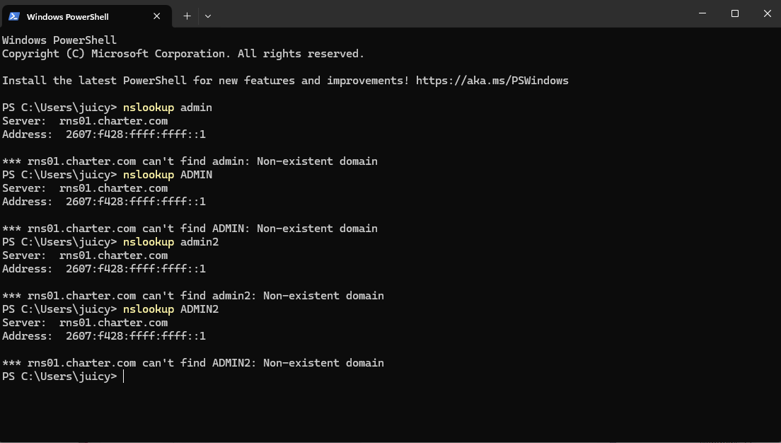

In your case, I see that you are using rns01.charter.com as your DNS server. That's the "server" line in the nslookup output. The problem is; that's your ISP's DNS server. Its not going to register the local names on your network. That's ok, because your PCs should be able to use Network Discovery to find each other.
You have the same issue that the guy in that first link had, the one that was initially broken. If you're curious you can read through that discussion.

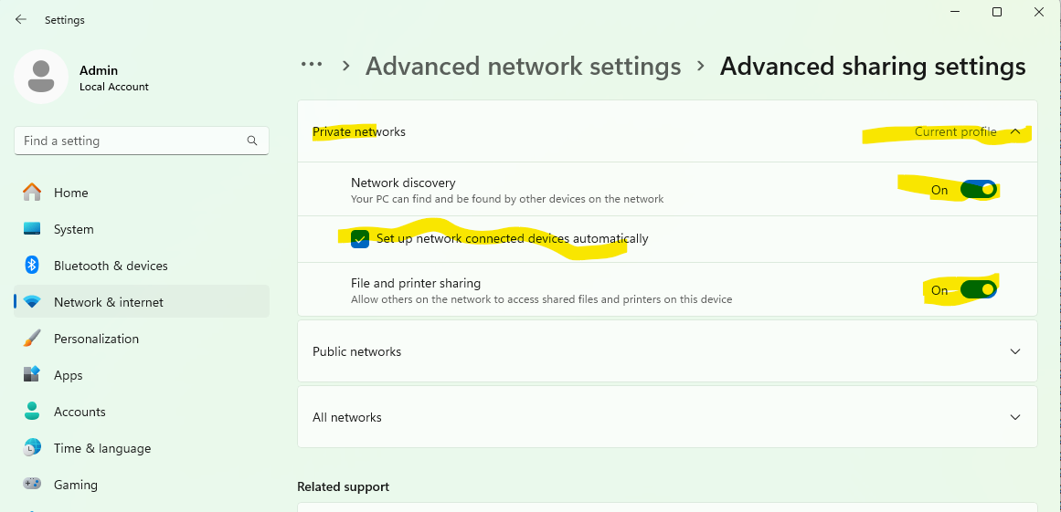

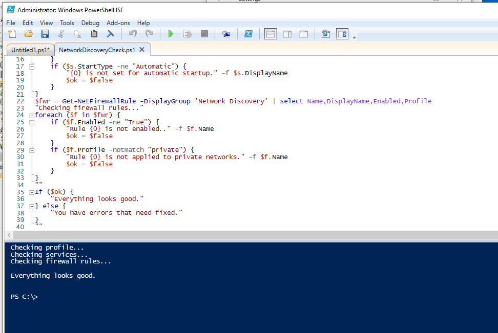

Let's start by verifying that Network Discovery is set up properly. I have tweaked the script that I posted in the second link. You should run this on both PCs.
On your start menu search for ISE. It should find Powershell_ISE. Open that with "run as administrator".
Copy/paste/run this script.
# CheckNetworkDiscovery.ps1
# This script checks to see the following:
# - That your network profile is set to Private
# - That the required services are started and set to sutomatic startup.
# - That the firewall rules have been enabled.
cls
$ok = $true
$np = Get-NetConnectionProfile
"Checking profile..."
if ($np.NetworkCategory -ne "Private") {
"Your network profile is set to {0}, it should be set to Private." -f $np.NetworkCategory
$ok = $false
$Svcs = "DNS Client", "UPnP Device Host", "Function Discovery Resource Publication", "Function Discovery Provider Host", "SSDP Discovery"
"Checking services..."
foreach ($sn in $Svcs) {
$s = Get-Service $sn
if ($s.Status -ne "Running") {
"{0} is not running." -f $s.DisplayName
$ok = $false
if ($s.StartType -ne "Automatic") {
"{0} is not set for automatic startup." -f $s.DisplayName
$ok = $false
$fwr = Get-NetFirewallRule -DisplayGroup 'Network Discovery' | select Name,DisplayName,Enabled,Profile
"Checking firewall rules..."
foreach ($f in $fwr) {
if ($f.Enabled -ne "True") {
"Rule {0} is not enabled.." -f $f.Name
$ok = $false
if ($f.Profile -notmatch "private") {
"Rule {0} is not applied to private networks." -f $f.Name
$ok = $false
If ($ok) {
"Everything looks good."
} else {
"You have errors that need fixed."
It should look like this. Note that it says "Administrator" in the window title.
