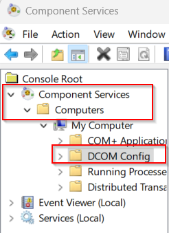

    To fix this, goto component services (dcomcnfg) and go to Computers > My Computer > DCOM Config.
    dcom
    Look for the application matching the CLSID in the Event Viewer warning.
    Go to Properties > Security tab, and under “Launch and Activation Permissions,” click “Edit.”
    Add NT AUTHORITY\SYSTEM and make sure it has both “Local Launch” and “Local Activation” permissions. Also check file system permissions for the folder. The IIS Manager user doesn’t map directly to a Windows account, but the FTP process still needs read/write access to the user’s folder. Usually, granting access to the IIS_IUSRS group or the Application Pool identity should cover this.
