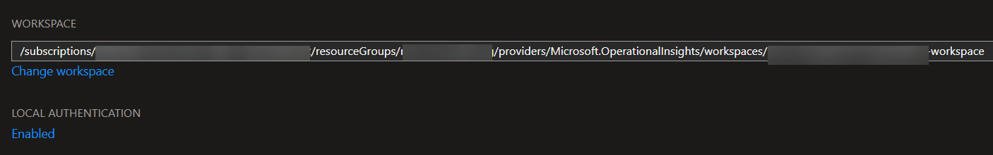

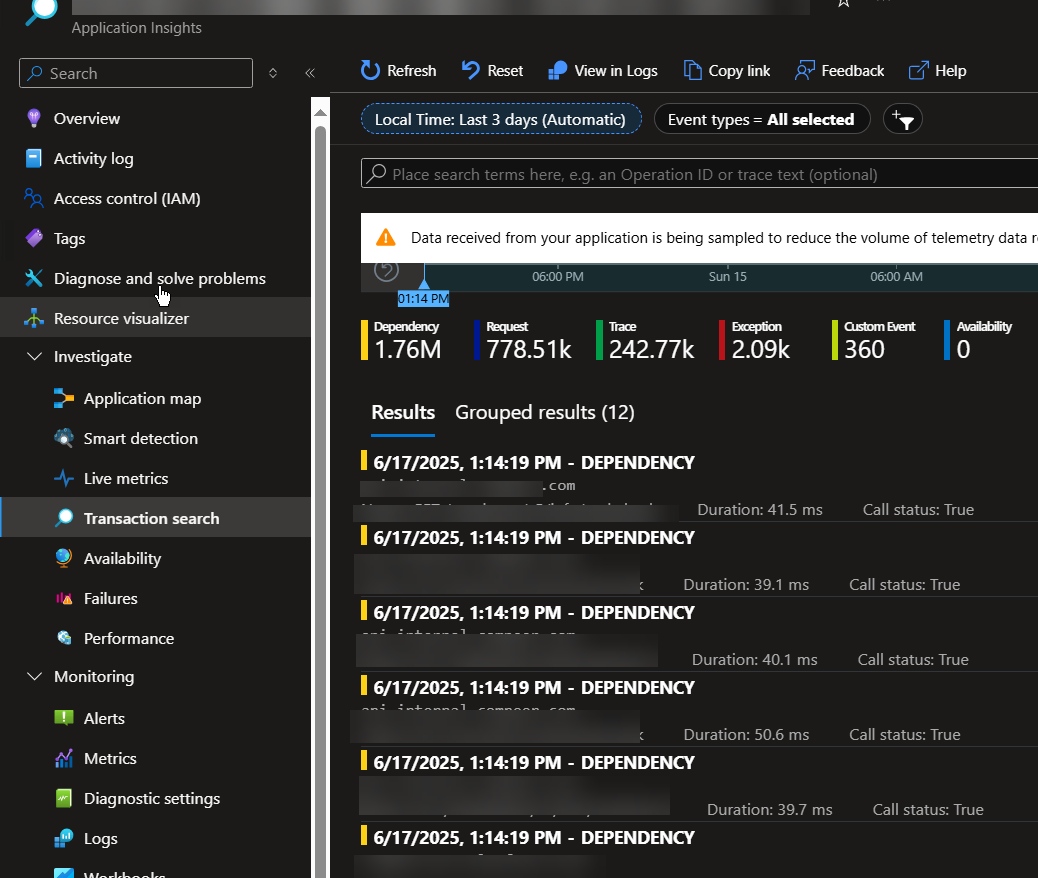

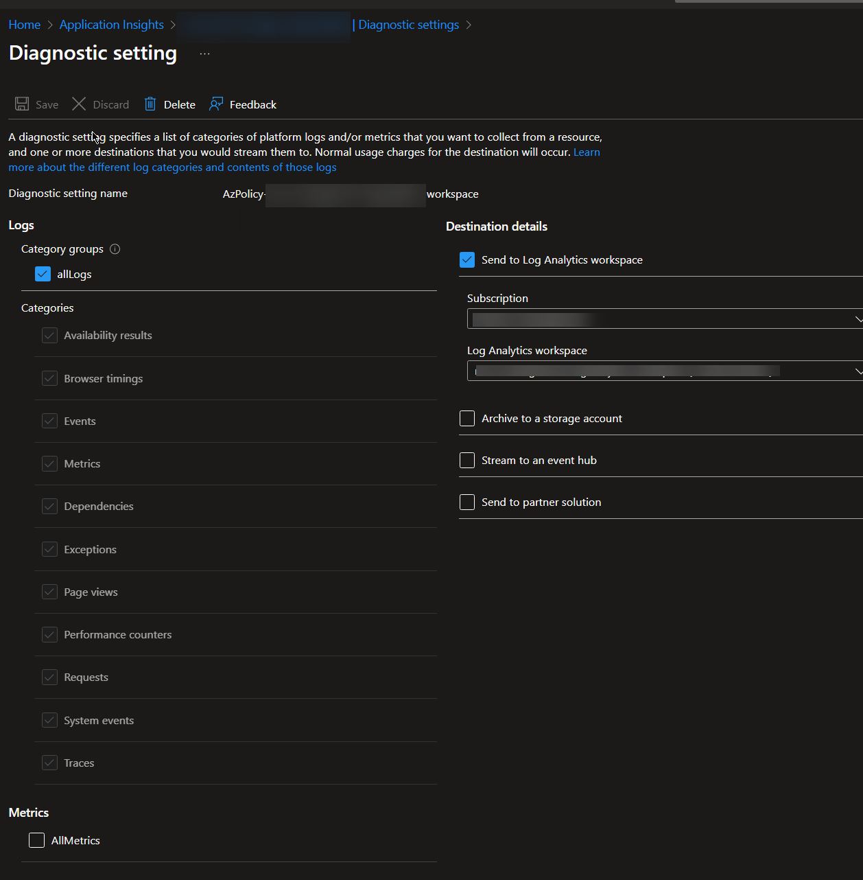

Azure Application Insights is showing duplicate entries in Transaction search. Application Insights has LogAnalytic workspace. It is configured correctly, but not sure why duplications. LogAnalytic configuration is applied through Azure Policy. THANKS FOR YOUR HELP in advance
duplicate log_configure logAnalytic_config

    Duplicate entries in Azure Application Insights can occur for a couple of reasons, especially when using Log Analytics workspaces. One common cause is when both the default telemetry pipeline and Diagnostic Settings are configured to send the same data to the workspace. This can lead to duplicate results in your queries.
    To avoid this, ensure that you do not configure Diagnostic Settings to send data to the same workspace that already collects Application Insights data. If you need to export data to a different workspace, consider using a Data Collection Rule (DCR) with a transformation and a custom table. This setup can help filter the data before ingestion and prevent duplicate records in your queries.
