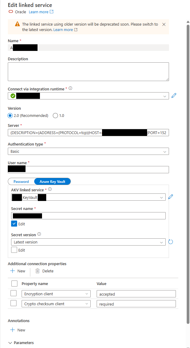

We currently have the Oracle v1 Linked Service configured and running with an Oracle 9iR2 database. It works with no issues. However with v2 it will not connect no matter what combination or Encryption client and/or Crypto Checksum Client we use. We've verified that the request does make it to the database.
The username and password is the same as V1 which tests successfully. I'm out of ideas.

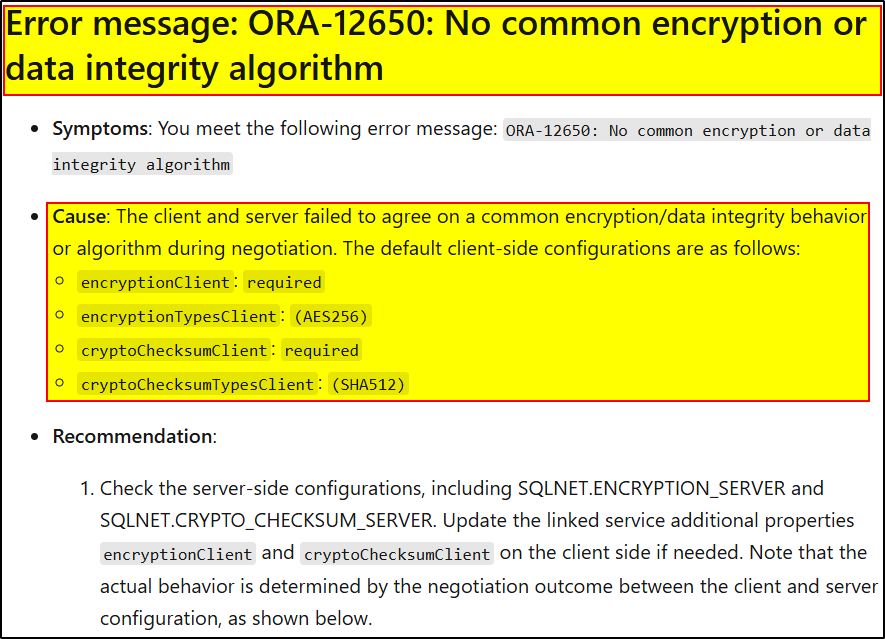

    You've done a great job troubleshooting this, and we understand the challenge of working with a legacy Oracle 9iR2 system that is still in production and cannot be upgraded. Given that you've already tried both Encryption client = rejected and Crypto checksum client = rejected, and are still encountering the ORA-12650: No common encryption or data integrity algorithm error, it confirms that the issue is rooted in protocol incompatibility between Oracle 9i and the v2 connector, which enforces newer encryption standards such as TLS 1.3.
    For additional information, please refer: Troubleshoot the Oracle connector in Azure Data Factory and Azure Synapse
