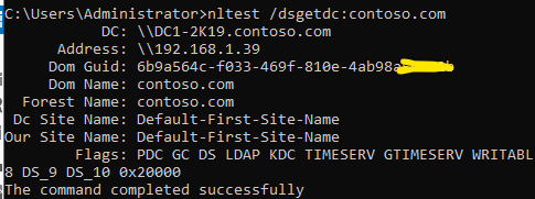

    • Run nltest /dsgetdc:yourdomainname to confirm the workstation can locate a Domain Controller. User's image
