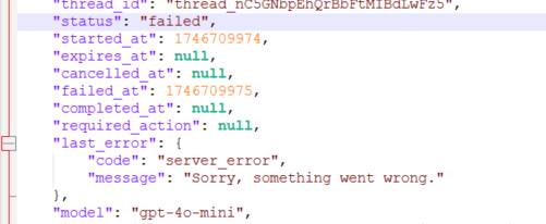

I am currently using Assistants/Threads/Runs to chat with a configured assistant in Azure OpenAI which has File Search enabled and some configured functions. I want it as much as possible to use the file search and get its answers from there, so when I post the Run, I am setting this body:
SQLCopy
JSONCopy
   "assistant_id":"{{AssistantID}}",
   "tool_choice":{
      "type":"file_search"
   "parallel_tool_calls":true,
When on the assistant side I set the model to be GPT4.1-mini, I am ALWAYS getting an unhandled server error as shown below:
Error text:
Copy
TypeScriptCopy
"last_error"
This is happening with all requests, even passing something as simple as "hello there".
If I change models to GPT4o or GPT4o-mini, the problem does not occur!
The problem ALSO does not occur if I empty the vector store that the Assistant is using, though that creates different problems. This is an OpenAI Bug clearly, has anyone else encountered it?

    I think you are having an internal bug in the implementation of GPT-4.1-mini, specifically when it attempts to interface with the file search tool (likely related to the vector store or embedding compatibility).
    You can use GPT-4o or GPT-4o-mini for now if you rely on file_search.
    Clear the vector store or avoid complex file setups temporarily if GPT-4.1-mini must be used (though that limits usefulness).
    For better assistance, try to report the bug to Microsoft Support.
