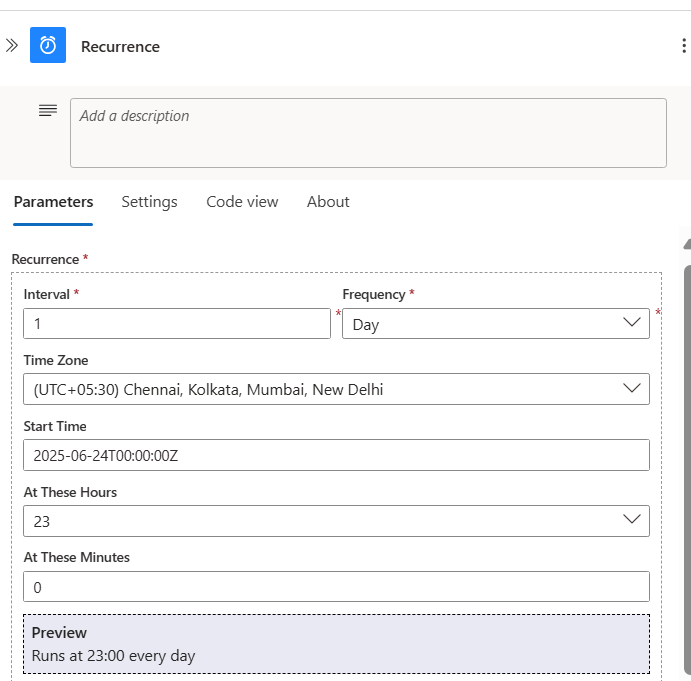

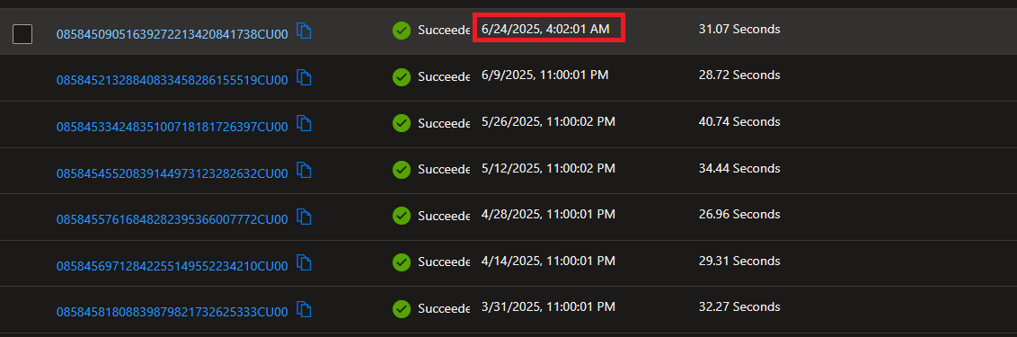

I'm using Standard Logic Apps, and I have a scheduled workflow that's set to run at 11 PM. However, I've noticed that on some occasions, it gets triggered around 4 AM instead. This issue happens intermittently.
I'm wondering if anyone else has experienced a similar problem?
