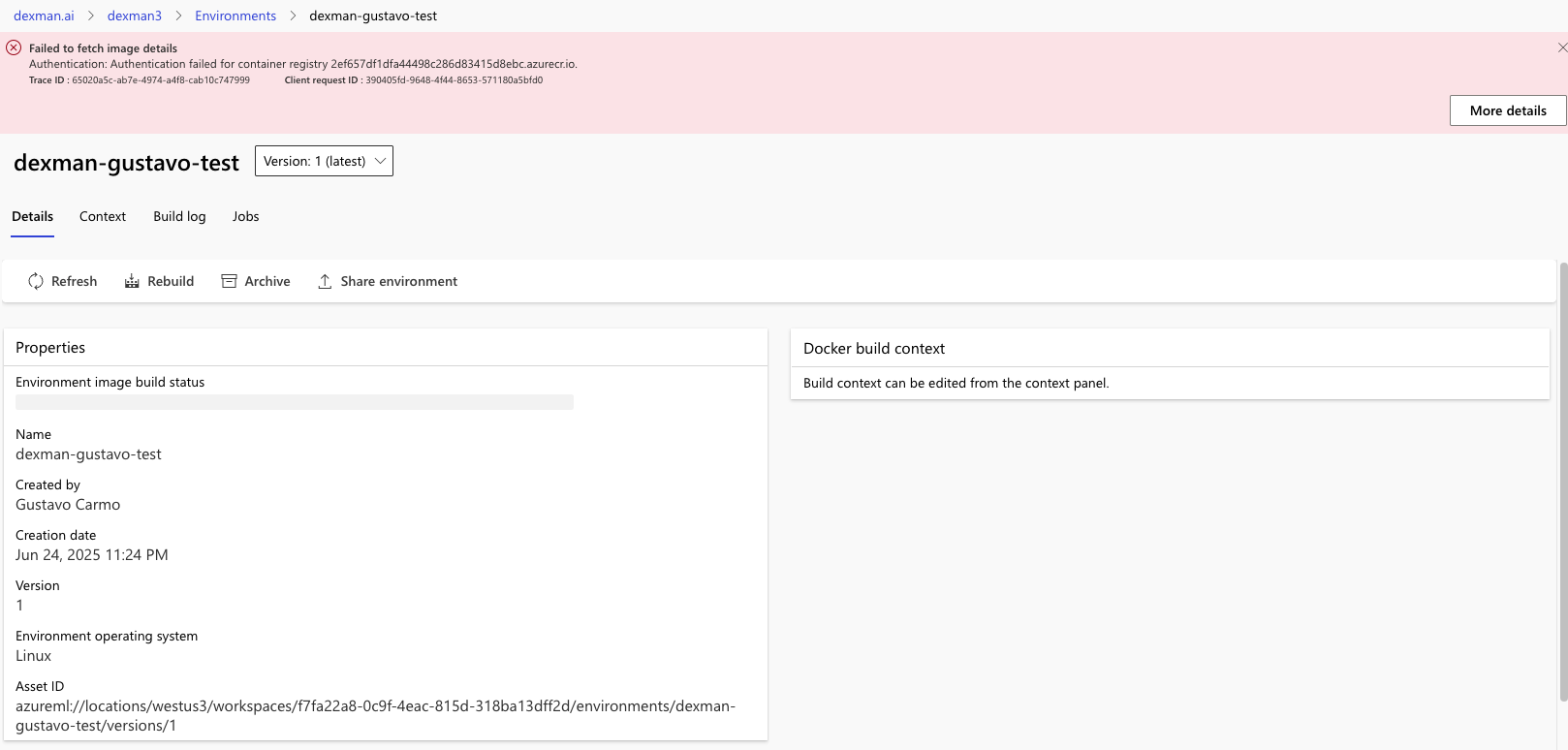

I have recently created a new Environment in Azure ML, and the first issue I see is that I am not able to get details from the image in the portal.
Failed to fetch image details Authentication: Authentication failed for container registry 2ef657df1dfa44498c286d83415d8ebc.azurecr.io. Trace ID : 6f4538d6-9593-4ae5-95ab-9eda460f4c16Client request ID : cc5c29b0-e198-485f-afc1-831b54004c7a1 - Azure ML Portal, cannot access container registry

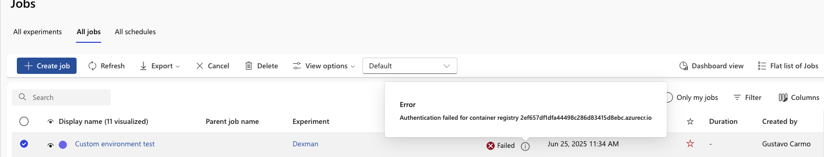

Subsequently, I cannot use that Environment in a Job.
For example, here is my job configuration:
$schema: https://azuremlschemas.azureedge.net/latest/commandJob.schema.json
command: echo "hello world"
environment: azureml:dexman-gustavo-test:1
display_name: Custom environment test
And here is the failure:
Authentication failed for container registry 2ef657df1dfa44498c286d83415d8ebc.azurecr.io 2 - Azure ML Job Failure

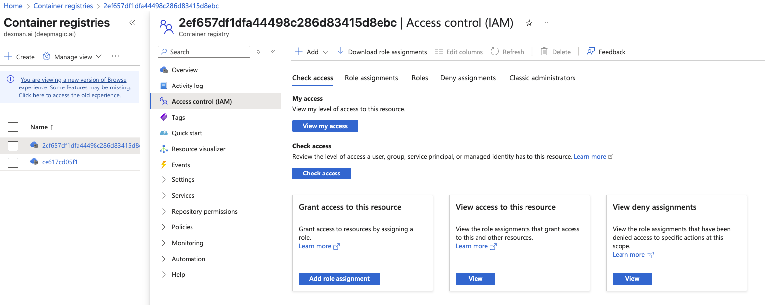

  1. Gustavo Carmo 5 Reputation points
    2025-06-25T15:32:23.23+00:00
    Adding an update:
    By accessing the Container Registry in the Azure Portal and assigning the proper role towards dexman3 (the workspace) I was able to get things working.
    With this, the problem seems to be this: When the Environment is created, the right roles for that Workspace to use that Environment do not seem to be set up automatically.
