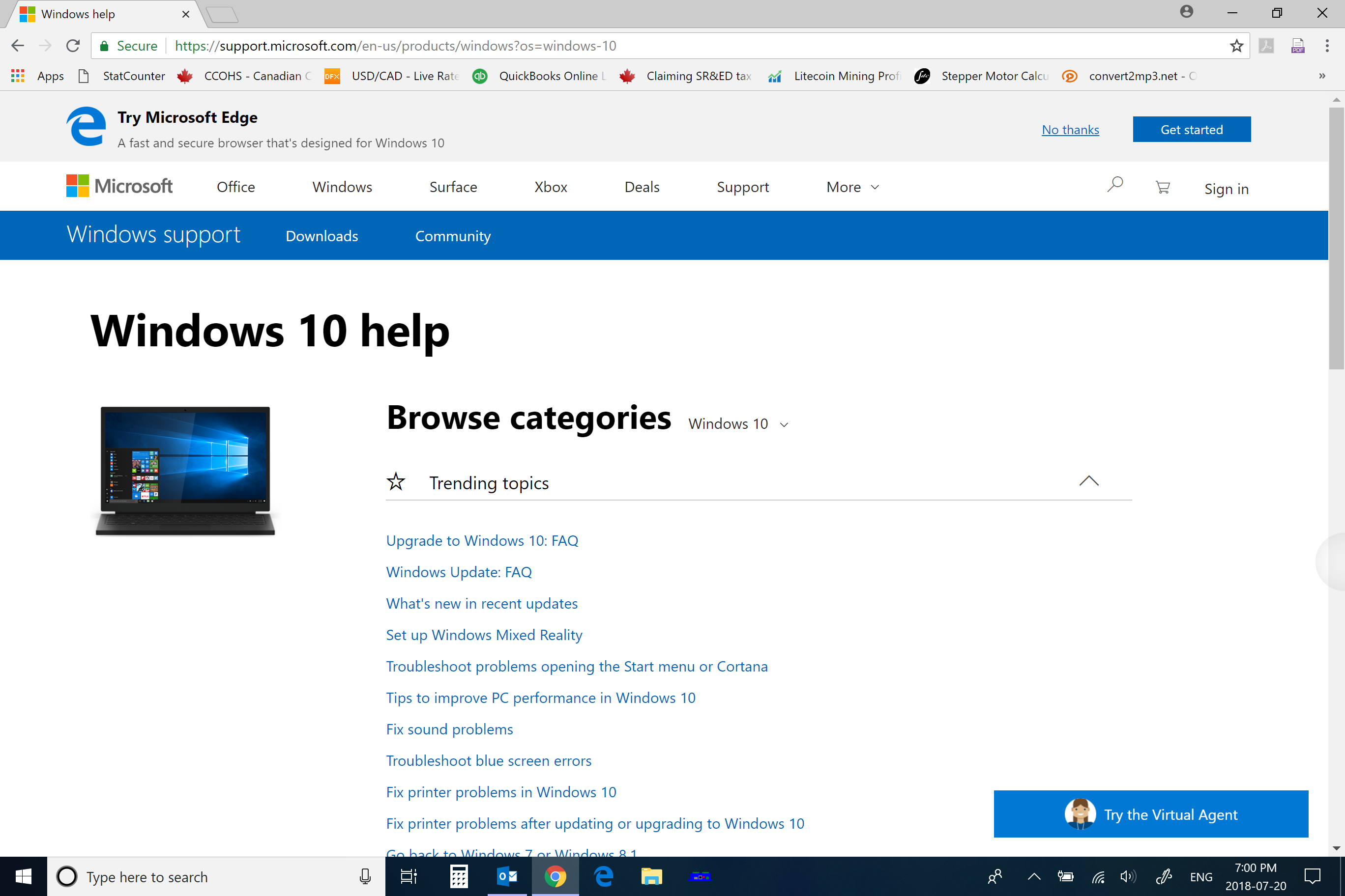

My Surface Pro 4 has an issue with an extra mouse pointer.  It appears on the right edge of the screen, just off the screen as shown below, but you can see a half circle around it visible on the screen.  If I hover over something with the active pointer and it turns to a hand symbol, the extra pointer also turns to a hand and it can then be seen.  This pointer never moves but affects the operation of the other mice and touchscreen.
The regular mouse pointer will flicker when moving and disappears when stationary.  It often cannot click on items.  Even the touchscreen will not be able to click on items usually.
I cannot swipe in from the right to bring up any menu items there.
Turning off the computer sometimes helps temporarily.
I have disabled the Bluetooth, no change.  Removed mouse drivers and HID devices.  No change.
I have changed the touch keyboard, no change.
I have switched to tablet mode and back.  No change.
I have disabled the track pad with no change.
I have tried to change the project screen from duplicate display to Surface display only.  No change.
If I connect an external monitor and close the Surface keyboard (so the Surface monitor is off) the problem goes away.  If I open the cover, the problem starts again, affecting both the Surface monitor and the External monitor. ![](https://learn-attachment.microsoft.com/api/attachments/2d9ab437-65af-4cbe-9dbb-5e3b85ec5145?platform=QnA
