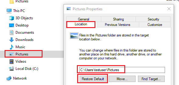

    1. Check the default paths of these backup folders (Documents, Pictures, Desktop)
    Open File Explorer, in the left sidebar, right-click the Picture folder, Properties, select the Location tab, and check its current path. Make sure it is C:\Users*yourusername*\Pictures.
    If not, please click "Restore Default" and then click Ok. You may see the following dialog boxes. Click Yes to move all files back to the local Pictures folder. Later, refresh the current folder in File Explorer and see if files appear.
    Repeat Step 3 to check the other two backup folders. Make sure their paths are not in the OneDrive folder.

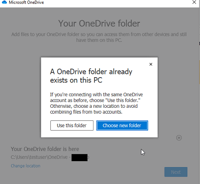

  2. Run OneDrive and sign into your new school account
When setting up, in the "Your OneDrive folder" dialog shown below, if it reminds you that there is an existing folder, click "User this folder". After that, I suggest you open the OneDrive folder and check if you can see these OneDrive files.
If it doesn't remind you that you have an existing folder or you don't see any files in the new OneDrive folder, you need to manually go to C:\Users*yourusername*\ and check if you can see two OneDrive folders, such as "OneDrive - schoolname". If so, open both OneDrive folders and move all files/folders from one folder to the new school account's OneDrive folder.
