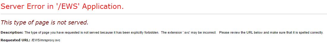

If manually go to the MRS Proxy URL (either internally or externally) I'm prompted for authentication. After putting in an admin login credential, I get the following page:

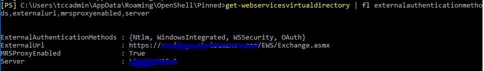

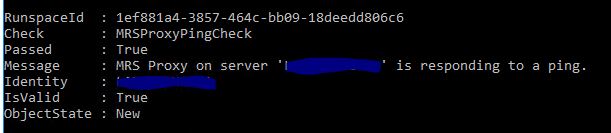

However, I have confirmed both via the EAC and via PowerShell (via Test-MRSHealth and Get-WebServicesVirtualDirectory) that the MRSProxy is enabled and responding to a ping.
