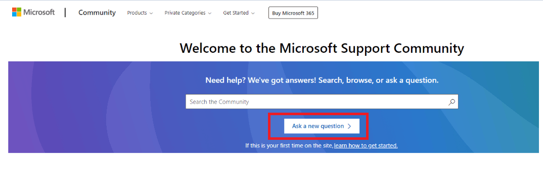

    Hi nikhil dagde,
    We haven't heard from you in 72 hours, so we assume that your issue has already been resolved. We will not be monitoring this thread going forward so, if you need further assistance, please create a new thread to discuss these concerns by clicking this link: Create a new question or start a discussion (microsoft.com)
    Thank you for your understanding.
