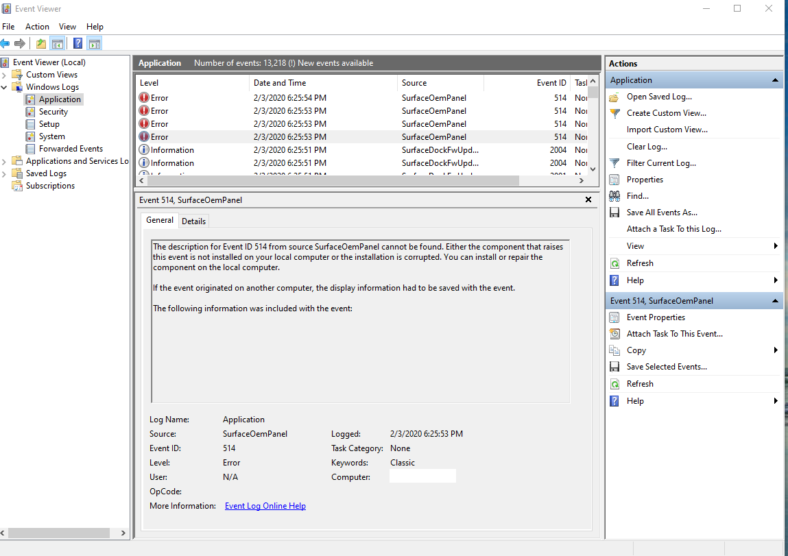

    2020-02-04T01:43:17+00:00
    I have a Surface Pro 3 which is attached to two external monitors. I have same error message, however, the "information provided with event" is blank, no information.
