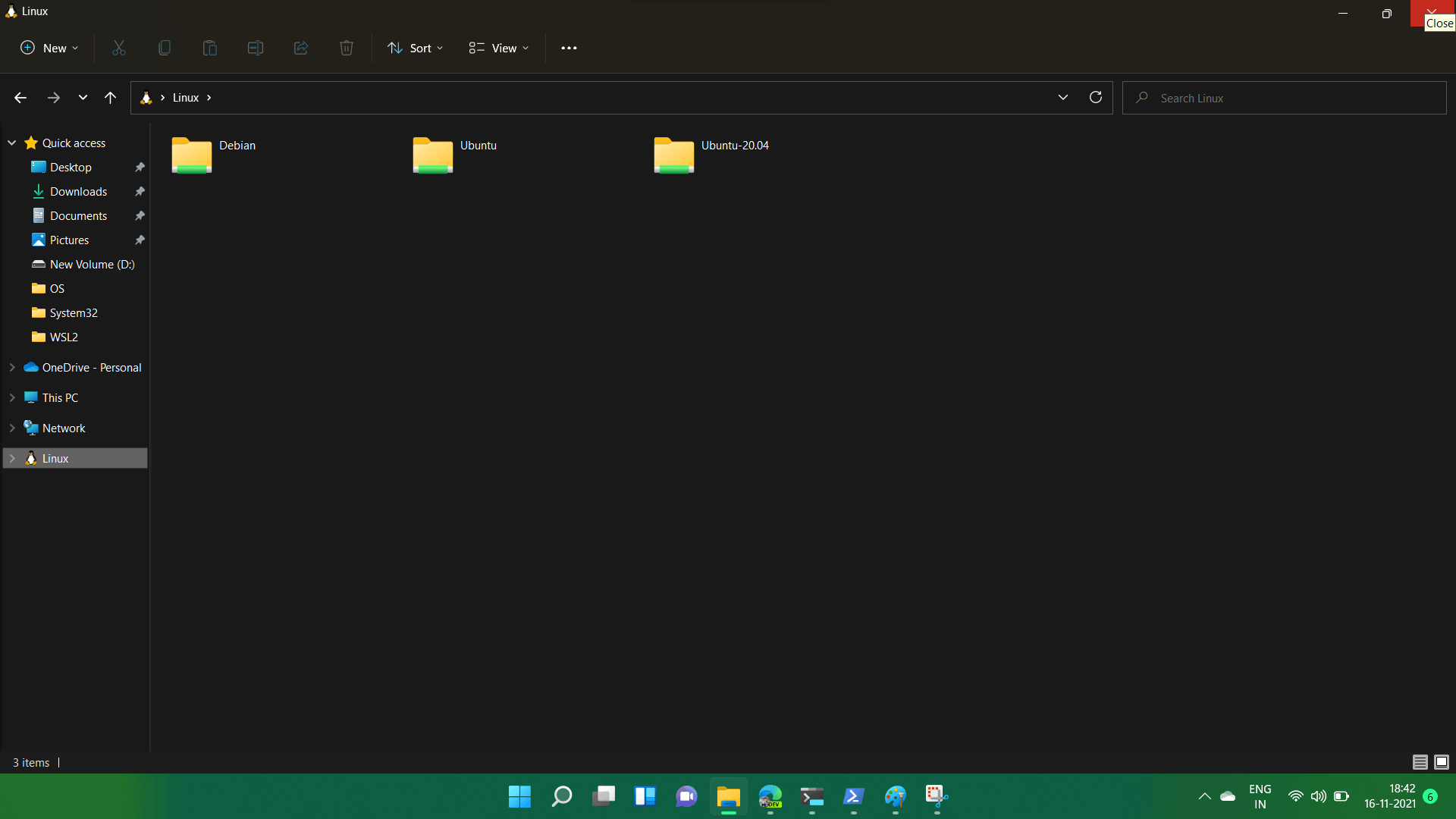

Navigating with files
When the Distro is installed, Windows would add an option in the File Explorer so that you can directly access the files.

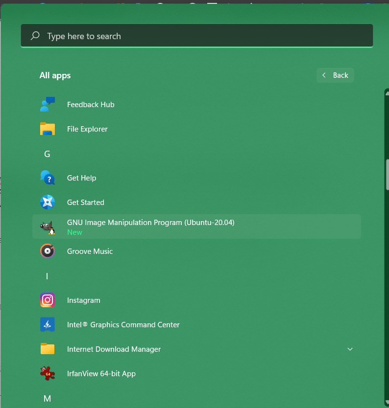

When the installation is complete, you will see the app listed in the Start menu. You can also cycle between apps using Alt+Tab.
4
GIMP installed using Ubuntu
