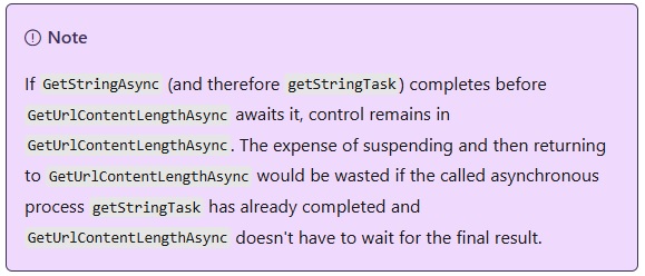

ifGetStringAsync (and therefore getStringTask) completes before GetUrlContentLengthAsync awaits it, control remains in GetUrlContentLengthAsync. The expense of suspending and then returning to GetUrlContentLengthAsync would be wasted if the called asynchronous process getStringTask has already completed and GetUrlContentLengthAsync doesn't have to wait for the final result.
q1) so if getStringTask complets before await then how could/should i write this code ?

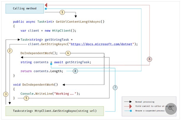

  5. SurferOnWww 4,951 Reputation points
    2025-07-10T01:29:16.52+00:00
    You took the description in your question from the note in the Microsoft document What happens in an async method.
    enter image description here
    You have to understand that the above note does not apply to the sample code because the operation form (1) to (8) below must complete to obtain the "contents.Length" (8) regardless of the completion timing of GetStringAsync.
    Be aware that the lines string contents = await getStringTask; and return contents.Length; cannot be skipped and must exit as is in the GetUrlContentLengthAsync method to obtain the "contents.Length" (8).
