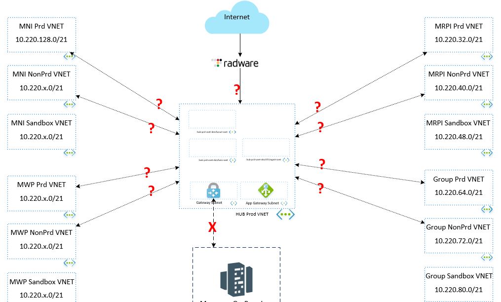

I have a Hub and Spoke VNet topology configured in my Azure tenant, all spokes are peered to a central hub vnet. My Hub vnet hosts my VNG (which I use to connect back in on-prem) as well as other central infrastructure (checkpount nvas, app gateways etc). I recently upgraded the VNG sku (to increase HA and make it zonally aware). The upgrade went smoothly but one of the symptoms of the upgrade is communication between my spokes and the central hub went offline during the upgrade. Note, this communication does NOT use the VNG , but it was still impacted by the VNG upgrade. Once the new VNG came up, the communication from spoke to hub came back. So my question is, does anybody know why a VNG going offline (which it did naturally as part of my upgrade) would impact communication between my spoke vnet and my hub vnet, even if the communication was not using the VNG?
