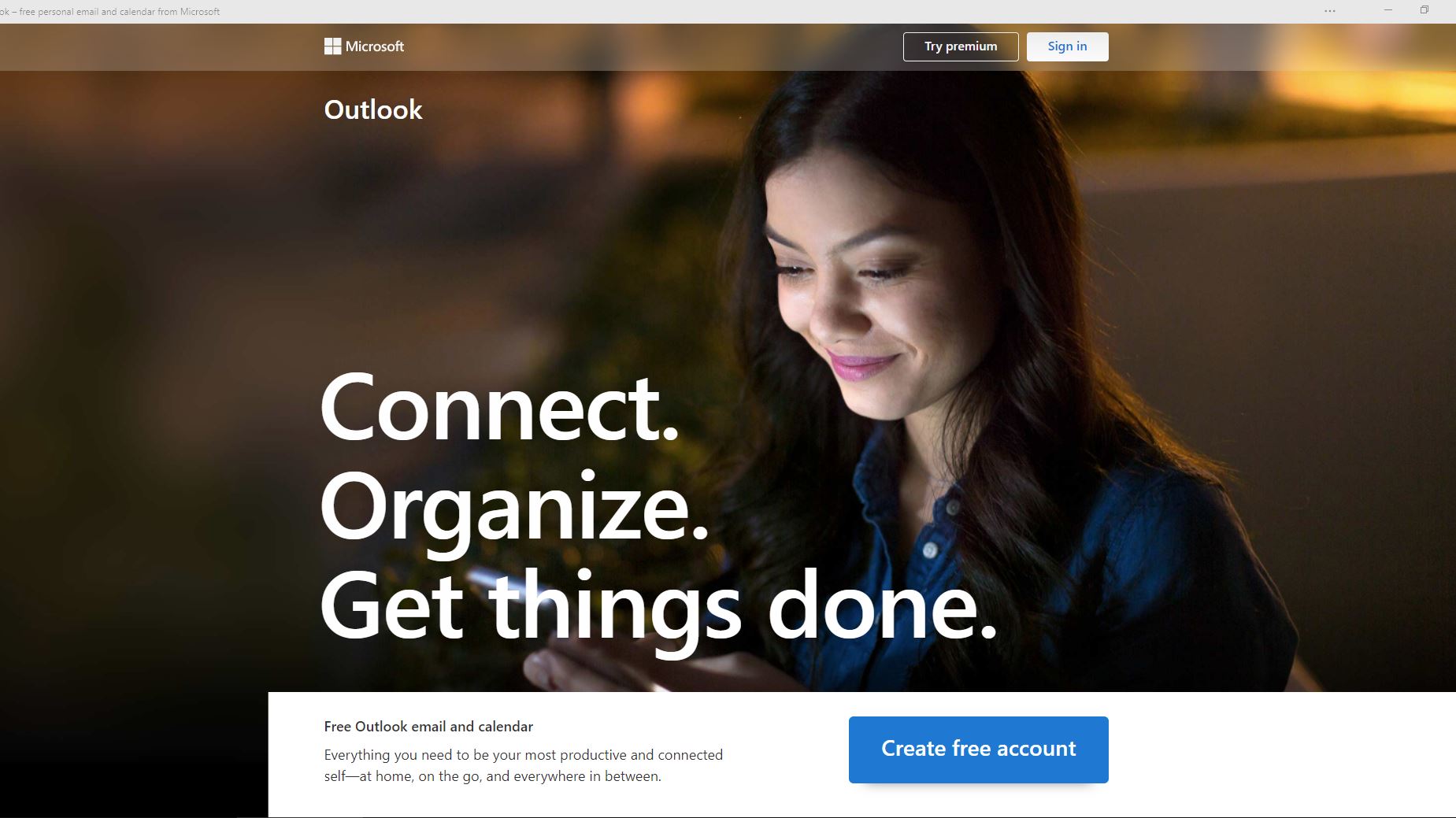

    The problem stopped but not for lone. It started again. Attached is what always comes up when I open Outlook.
