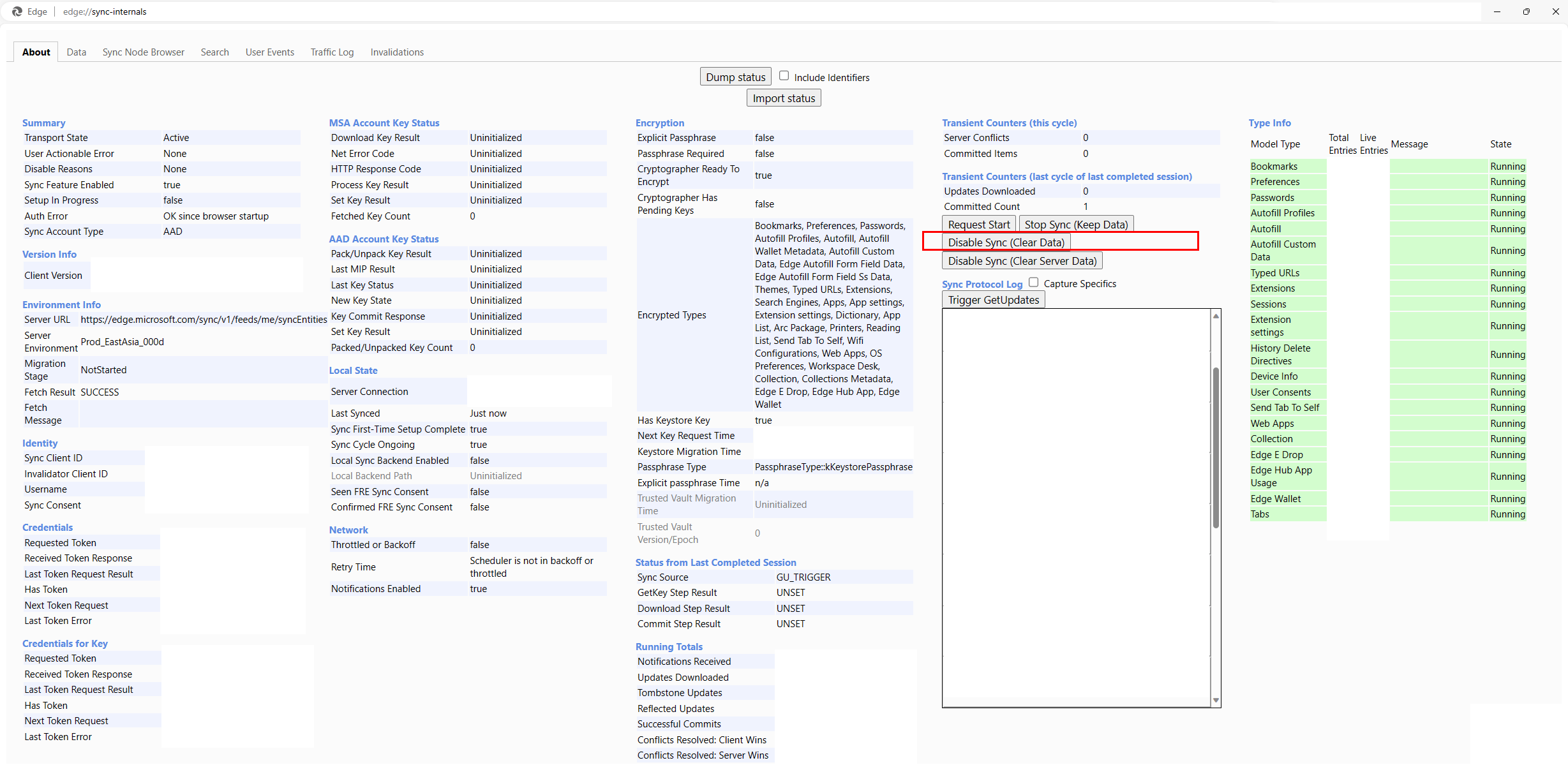

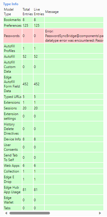

This is what the edge://sync-internals page read:
The full passwords message says "Error: PasswordSyncBridge@components\password_manager\core\browser\sync\password_sync_bridge.cc:269, datatype error was encountered: Password metadata store isn't available."

    I have checked in multiple accounts that this synchronization feature works correctly and from the error messages it seems that the problem is most likely an anomaly in the relevant file in the browser client configuration file. You can try the following steps:
    1. Repair the Microsoft Edge browser
    "Win" logo key + "I" open Windows Settings > Apps > Apps & Features > Microsoft Edge > Modify > Repair*.*
    2. Clear sync data
    Click “Disable Sync (Clear Data)” on the edge://sync-internals page. The location of this button may change due to the page layout, so please look for it carefully and check.
