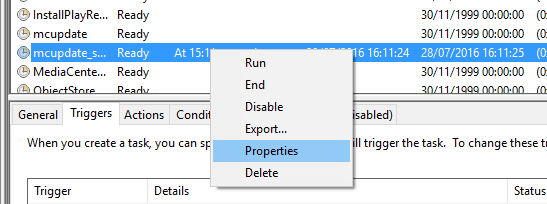

    2016-07-28T19:15:09+00:00
    It is not entirely obvious but you need to right click the mcupdate_scheduler entry in the list and select "Properties"  That opens a new window in in that all the fields are changeable
