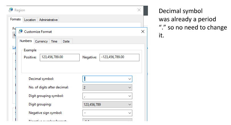

  2. checked the region decimal symbol. It was already a period "." No need to change it.
