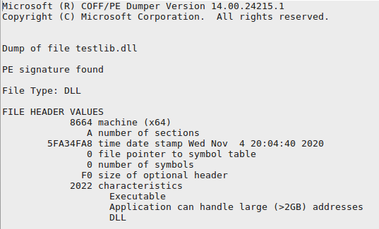

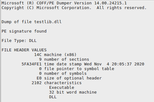

  2. RLWA32 49,666 Reputation points
    2021-01-29T12:05:59.53+00:00
    Are you absolutely sure that the C++ DLL that is being used by the C# code is actually a 32-bit DLL?
    If you mistakenly copied a 64-bit DLL to the folder that contains the C# executable that is the DLL that will be used since your example does not provide a path to the DLL in the DllImport statement. A subsequent build of a 32-bit DLL C++ project will not necessarily place the DLL output where C# will find it and so the wrong DLL (64-bit version) will be used.
    You can verify the bitness of the C++ DLL being used by running dumpbin /headers on it. For examples of the output that show the bitness of a DLL -
