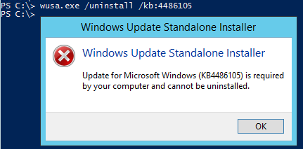

  2. Sam 96 Reputation points
    2021-01-29T16:51:34.647+00:00
    Hi Adam, thanks for the reply. Yours is one of the guides I was following.
    Unfortunately I am unable to uninstall the problem .NET versions. Screenshot attached here of trying to uninstall .NET 4.8 but I get the same for the 4.7 variants too.
    I'm going to try upgrading to Server 2019 as that seems to be the only version where WSUS is compatible with .NET 4.7 and up installed.
