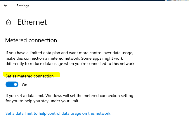

  3. Xiaowei He 9,936 Reputation points
    2021-02-01T06:42:47.487+00:00
    What is the OS of the Hyper V host?
    If the OS is upper windows 10 and Windows Server 2016, we can enable the metered connection on the Hyper V host.
    Thanks for your time!

  5. Xiaowei He 9,936 Reputation points
    2021-02-04T01:58:36.79+00:00
    I know I can set the host to use the metered connection but if I don't check off that option I am wondering if the virtual machine is smart enough to know that the host is on a metered connection so it doesn't download windows updates over a cellular connection
    It needs to test while we didn't have the environment to test for you, you may try to enable the metered connection on the VM, check if it could work.
    I am curious to know if it is possible to block the connections to the host. For example, if the host is connected to a VPN the VM can access the resources from the VPN tunnel. Such as network shares, is it possible to configure the VM to not allow that.
    I am also curious, if the host connect to the VPN server, does the VM connect to the VPN automatically? Does it work in your environment?
    If yes, as far as I'm concerned, you may add another NIC on the Hyper V host that can access the VPN server for VPN connection, at the same time, make the physical NIC used for external virtual switch not have access to the VPN server, in this way, the VM connect to the external virutal switch won't have access to VPN server, so won't have access to the internal network.
