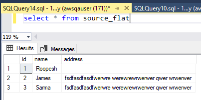

    Data in source:
    Note that the first row has an empty string for the address and this is what gives the error.
    If I update the address column of the first row to a string value, the package goes through fine.

    Now we know the scenario:
    When loading data with identity insert ON to an Always Encrypted destination table using ADO.NET connection, and if the source column has an empty string for an encrypted column, then SSIS throws the error nvarchar(4000) does not match with nvarchar(column size in destination table). Why is it behaving so and what is the fix for this?
