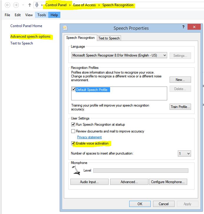

Are you putting the program to sleep by saying Stop Listening, rather than turning the microphone Off? When the microphone is in the Sleeping state, system resources are used as the software is monitoring for the Start Listening command. If you rather just turn the microphone Off and have the Speech Bar available:
  1. Go to Speech Recognition in Control Panel
  2. Click Advanced speech options
  3. In Advanced Speech Options remove the checkmark from Enable voice activation.
See screenshot below where the checkmark is there, meaning it will hear Stop Listening/Start Listening and microphone is Sleeping rather than without the checkmark where the microphone goes to Off when you say Stop Listening and it will not use the system resources.
