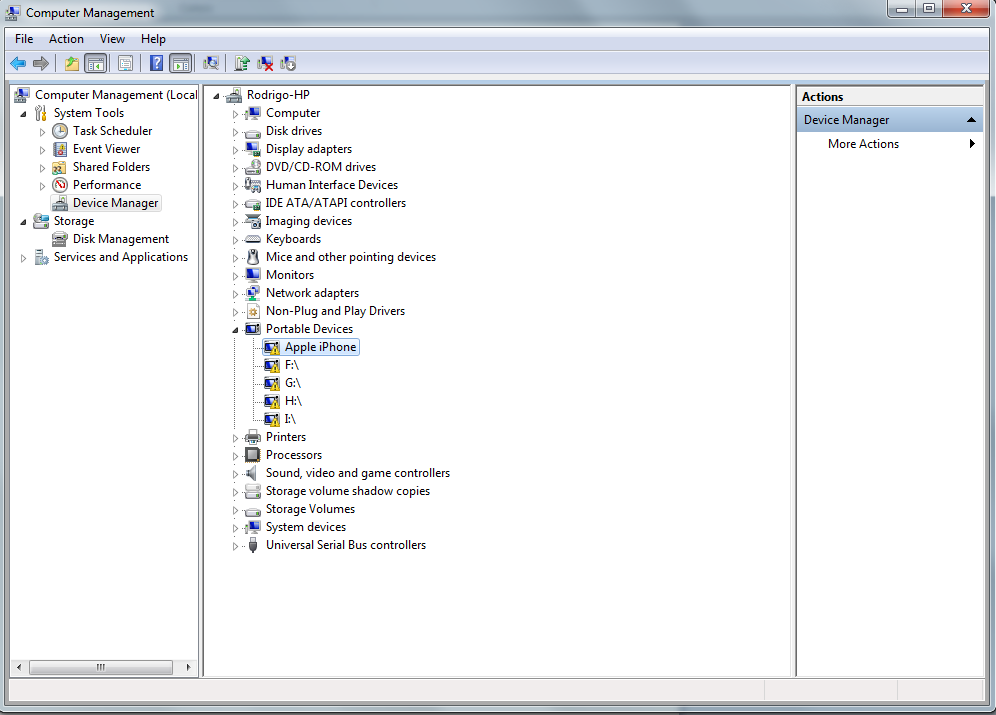

Hello I have search through the questions and answers however no suggestions seem to help my issue.
My portable devices(camera canonA3300, iphone, or anything else that is MTP) use to work perfectly. It wasn't until yesterday nothing was being read. However when i plugged them in i could hear the connected sound. I tried these devices on another computer and they work perfectly.
I went immediately to computer management>device manage> portable device  and I notice a yellow exclamation point triangle on every device. Even empty removable disks like (F:, G:, H:, I:)
I checked the properties of the devices containing the yellow triangle and it states. "This device is not working properly because Windows cannot load the drivers required for this device. (Code 31)
What I did in attempt to fix this issue.
  1. I restarted my computer thinking it would be a quick fix but no progress
  2. I uninstalled the device Drivers. However upon plugging back my device the yellow triangle would reappear on all devices and error code 31.
  3. I begin to notice software not working like my printers scanner. So I decided to system restore. upon doing system restore i had an error 0x80070005
I google the error code and it said it was an access denied error due to my anti virus conflicting to the restore.
  1. I deleted my anti virus and tried to system restore again the same error persists 0x80070005.
  2. Continue to google and find no solution. I went in safe mode and attempted system restore.
  3. This fixes the code 0x80070005 and successfully does system restore.
  4. in joy thinking this had fixed all my issues it still remains as triangles.
  5. i goggled code 31 and came to an about article on code 31 and followed the solutions. I had done everything it states but not delete "upperfilters and lower filters registry value" I proceed with the instruction and deleted these registries but it did not help my issue the triangles and code 31 where there.
  6. I found Microsofts fix it software for "hardware and devices" however all this crummy software does is uninstall and re install the driver which is what I have already done! i tried to send the feed back but as suspected errors appear.
  7. I tried windows " find and fix problems with devices" software and does exactly what the fix it software does.
I am now here and stuck. This is a work computer where there are estimates made for work and I need to import photos from my camera to place on the estimate. I've pulled out half my hair.
System recovery is not an option. too many important software and data on this computer. I have it backed up but im not taking 20+ hours to re install everything.

    I've tried to do roll back before you mentioned it and that did not work at all because there is no roll back option on my drivers.
    I've tried all 3 methods you posted and none have work I've tried to install all drivers but no fix.
