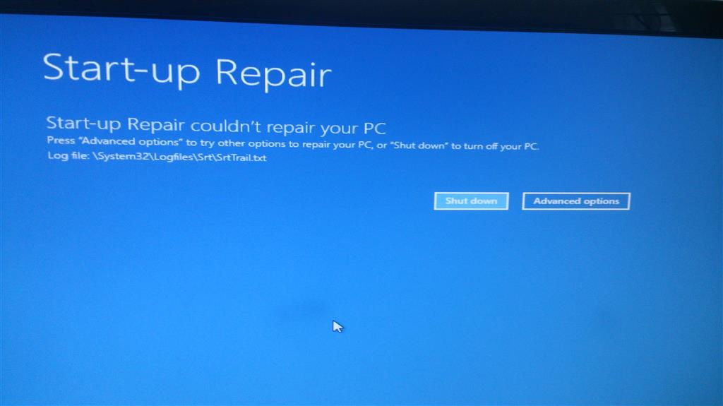

Using a Windows recovery USB disk I tried to automatically repair startup problems - that also failed:

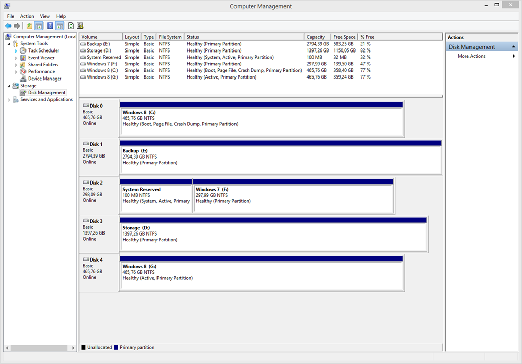

After switching back to the old HDD, booting up in Win8.1, connecting the SSD to check it's state I get this view in Disk Manager:
Notice that the cloned drive G: is also marked as active. Is that right? I did try to set it as inactive then reboot, but I still got the same errors.

Also, notice that the disk numbering is different. Is that of significance?

While we're at it, my new SSD drive is still marked as active after the last clone. So I have to drives marked as active. Is that really ideal?

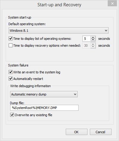

    A follow up. The Win7 boot loader defaulted to my old Win7 disk so I changed the default to Windows 8.1.
    Upon rebooting the Windows 8 boot screen was back!
    Maybe that's expected behaviour, I don't know... but at least it's all working now.
