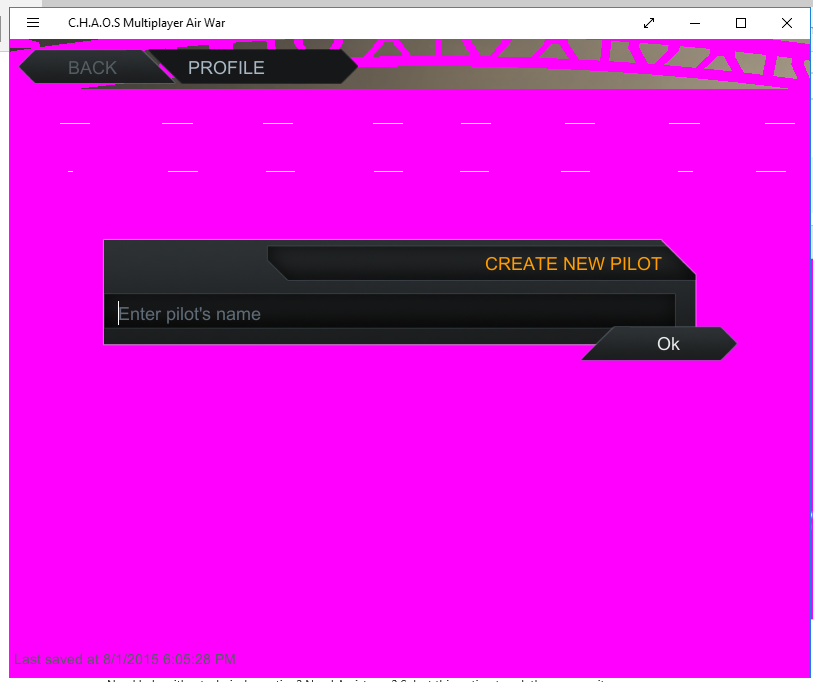

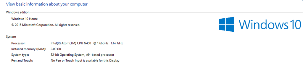

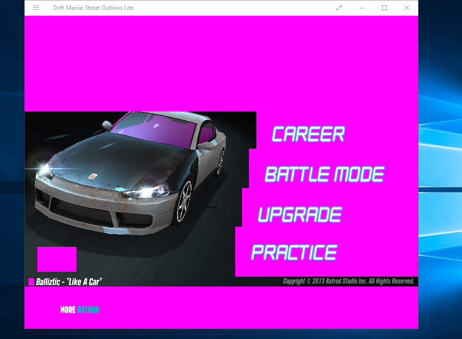

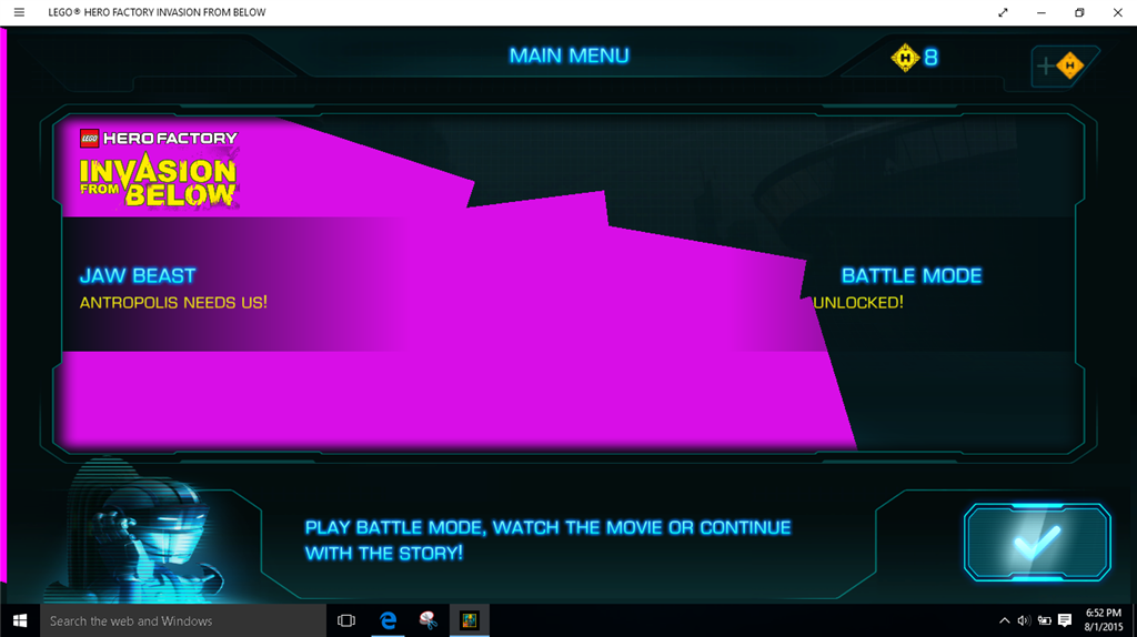

Hello,
I just updated to Windows 10 Home from Windows 7 Starter.  The issue I am having is a pink screen on many games from the game store I have attached screen shots of my pc info and the pink screen So far I have tried another user account and updated graphics driver. Everything else seems fine so far. Any info would help. btw these are all random games used to see if it was the game or the pc.
Sony Vaio VPCW212AX

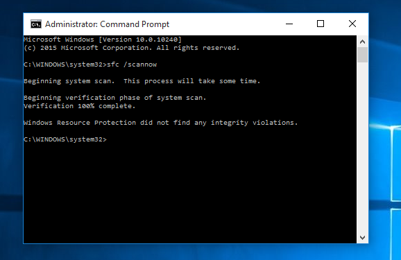

    HI,
    I have tried as you recommended the SFC check however no errors were found.

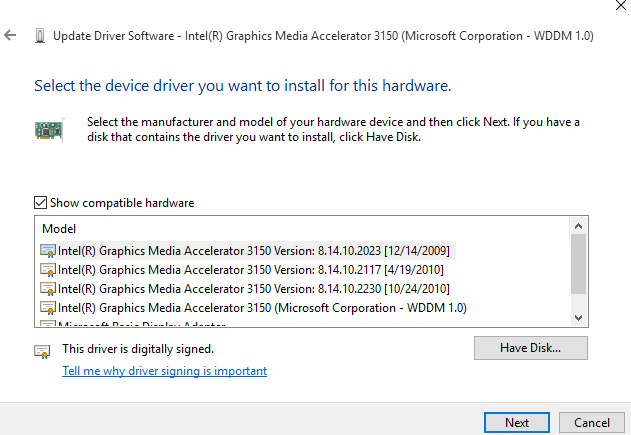

    I have also tried clean install this time upgrading to 64 bit OS and I am still having the same issue. Next up I tried installing older drivers from Intel. The current installed driver is 8.15.10.2697. I tried the following drivers from https://downloadcenter.intel.com/search?keyword=Intel%C2%AE+Graphics+Media+Accelerator+3150+(Intel%C2%AE+GMA+3150) I tried WIndows 7 64 bit Versions 8.14.10.2230, 8.14.10.64.2117, 8.14.10.64.2023.
    Next I decided to uninstall all drivers and manually use the Microsoft Basic Display Adapter. And the pink issue did not occur however the games and all video was lagging a lot.
    Hope this info helps pinpoint what the issue could be.
