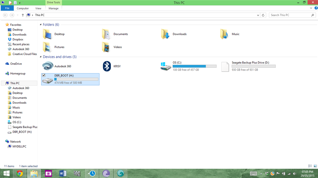

My 1TB external hard drive created a drive entitled DBR_BOOT due to the program dell backup & recovery and it is sharing memory with my 1TB hard drive, i would like to know how to remove this dbr_boot drive  please need help asap. thanks alot

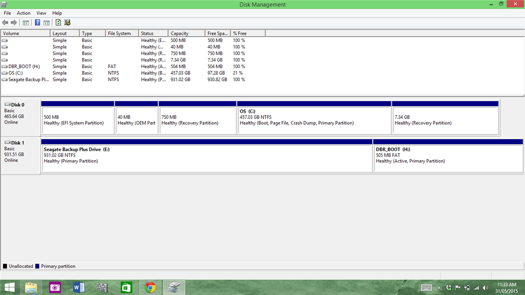

    1. What is the make and model of your computer?
    2. Are you able to view the drive in Disk Management?
    3. What happens if you disconnect the external hard drive?
    Post back us with results. We’ll be glad to assist you.
    2015-05-31T14:44:19+00:00
    My Laptop a Dell Inspiron 11 3000 Series, yes im able to see the drive in disk management and if i disconnect hard drive the seagate hard drive and the dbr_boot drive removes.
