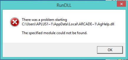

I've recently removed/uninstalled (via control panel's Programs section) some programs with the intention of removing unused or unknown programs.  After re-starting windows I've started getting this RunDLL error with these texts:  "There was problem starting .... C:\Users(user name)\AppData\Local\ARCADE~1\AgHelp.dll ........ The specified module could not be found....... (OK)"
Apparently there's a program calling for this file.  I've tried searching the Registry via Regedit and Task Manager but I have not seen anything that might be doing this.  Is there someone here who may have encountered a similar situation and know a way to stop it?  Thanks.

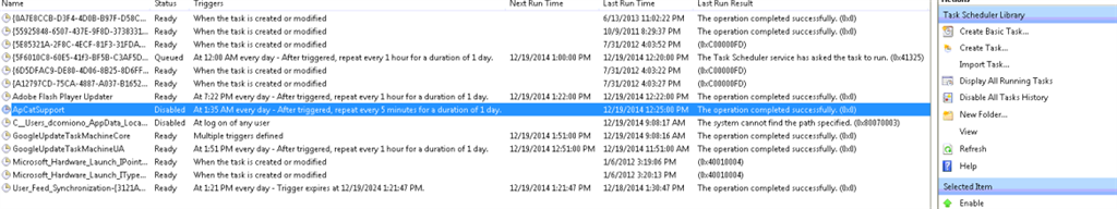

    1. Disable the task it created. Even after deleting it from the registry my user still got the error, then I found it in the task schedule. (I've attached a screen shot of what you should look for.
    -Click start and search for "task" you will see task scheduler (or schedule tasks), open it.
    -Look for the "apcatsupport" task under the task scheduler library.
    -Right click it and disable it.
    To be honest, if you aren't 100% comfortable with computers, I would skip step 1 and just do step 2, the task itself is what triggers that DLL error.
